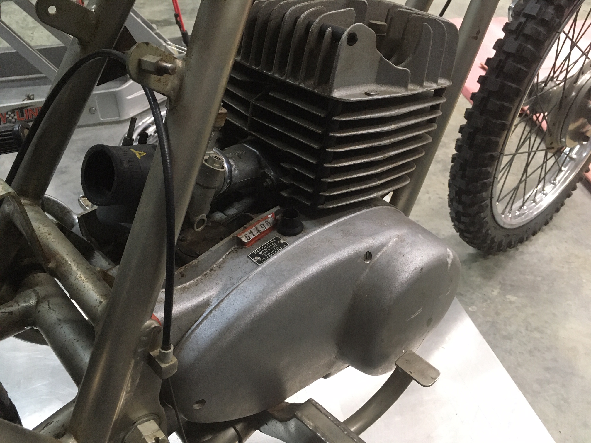

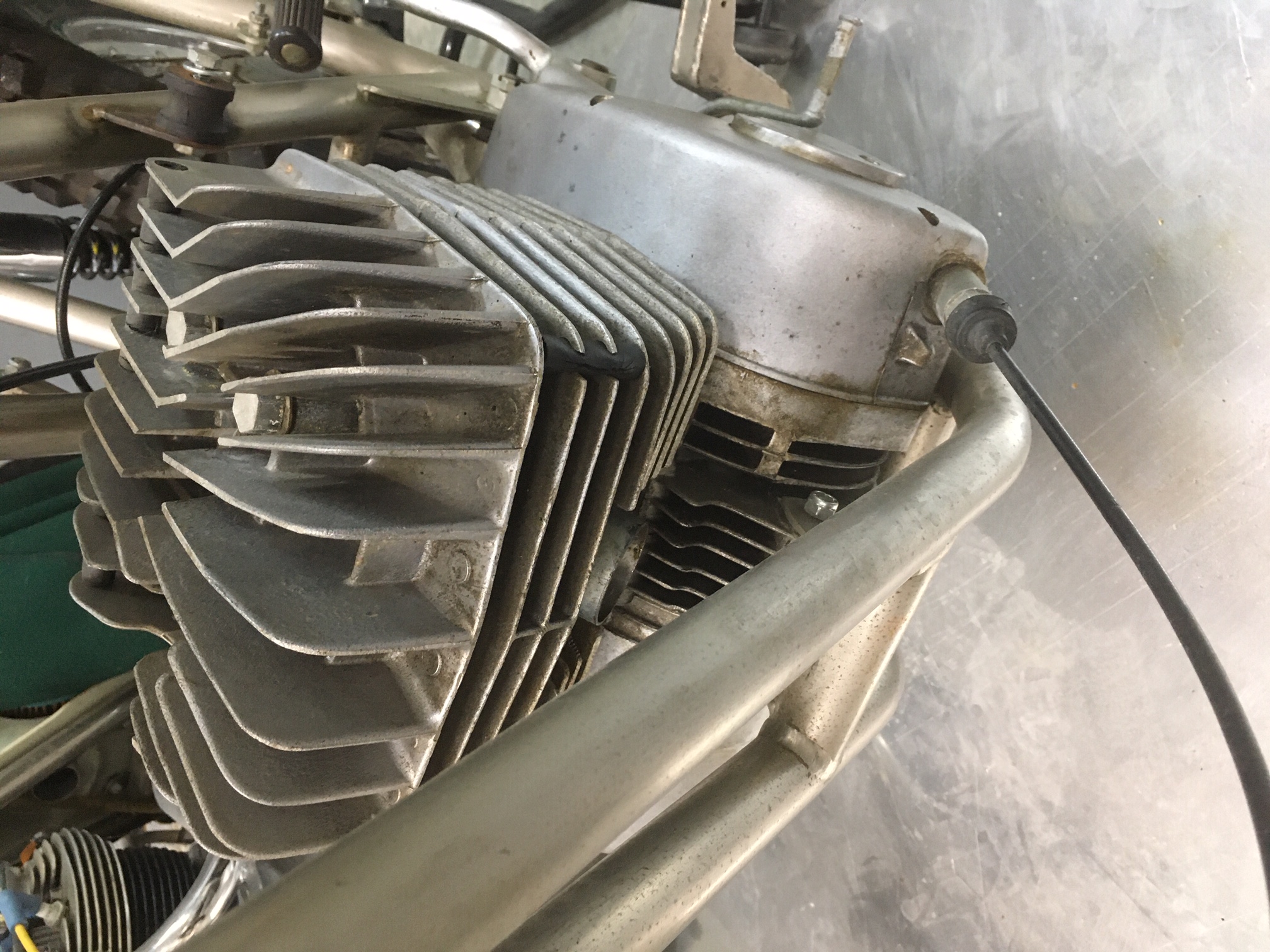

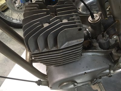

Here are some pics of the Rickman MZ Metisse. I've torn the bike down to gently restore the nickel plated frame which is overall in excellent condition. The motor is a 250 ISDT motor. It has great compression, but the dynamo is a wreck.

Postby Puffs » Thu Nov 21, 2019 5:05 am
Thanks!
What I'm seeing looks quite gorgeous. Front hub looks similar (if not same) to my '68 CZ 980. Are those footrests really non-hinging?
In classic MX, at least here in Europe, everything needs to remain as close as possible to how the bike was originally made. But an exception is made for the ignition: electronic ignitions are accepted, and many people have them. Don't know what it's like for enduro machines, but for a bike like this I would consider one of those nice Vape sets; that would sort out your dynamo.

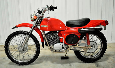

In the mean time some internet pics of the factory MZ ISDT machine:
MZ ISDT ('69 - '74), RH.jpg (54.36 KiB) Viewed 937 times
MZ ISDT ('69 - '74), LH.jpg (53.93 KiB) Viewed 937 times

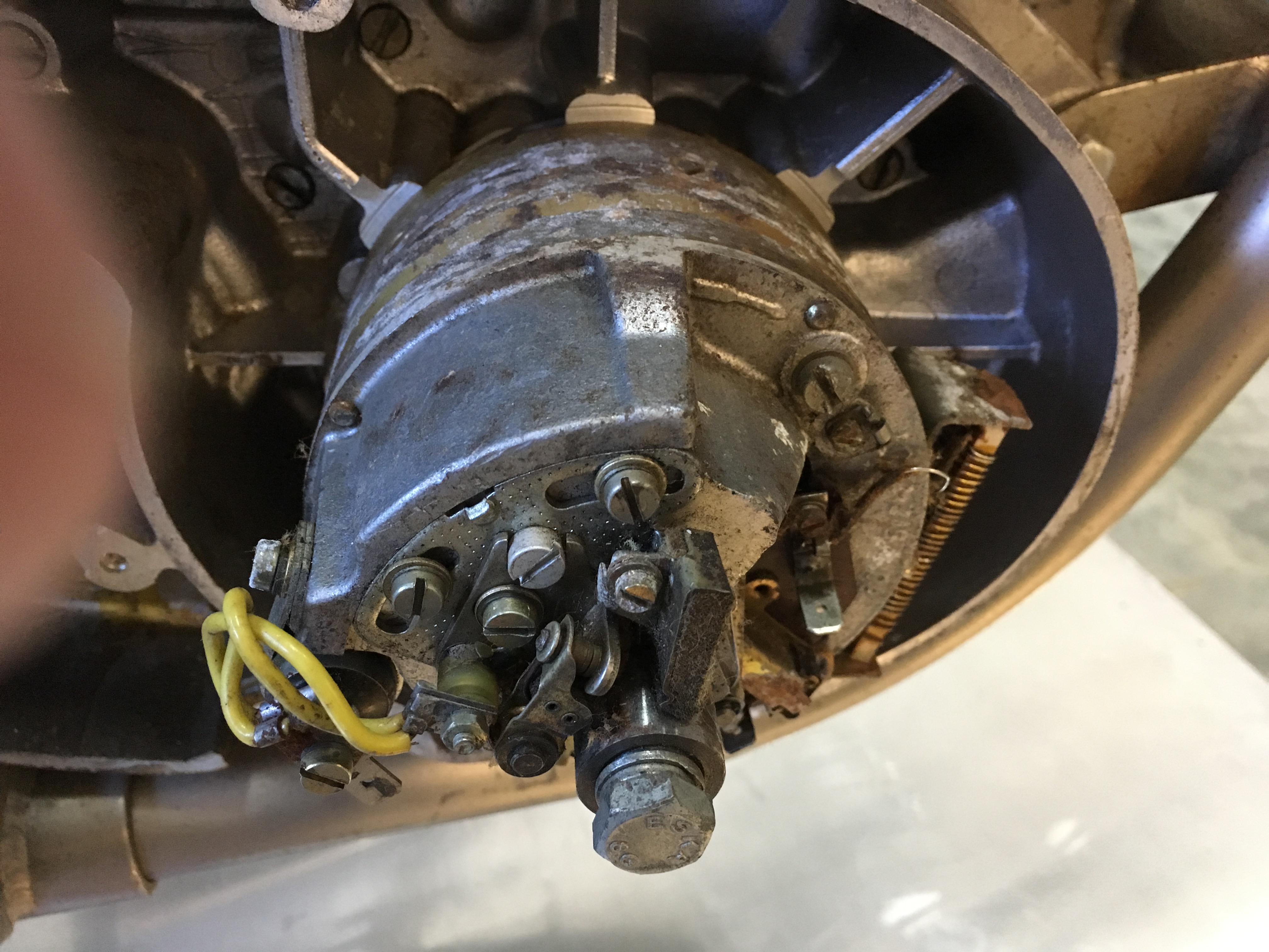

Here's a picture of the dynamo after I cleaned it up. I'm about to pull it out.
Are there any manuals for rebuilding these motors in English. I purchased a maintenance manual in German, but it doesn't cover tear down in much detail. I have a wiring diagram for the ISDT bike, but I'll have to sort out the dynamo by just learning as I go.

That looks quite familiar. Does it have a battery?
Anyway, I'd think improvement is possible, unless of course you aim at keeping it entirely original.

No battery and no room in this machine. And no electronics to accompany the dynamo - just direct output sent to the dual-coil arrangement with a small capacitor bridging across each coil. A toggle switch was mounting to switch between coils.

OK, then they replaced the standard battery-driven field coils by magnets. Makes sense.
