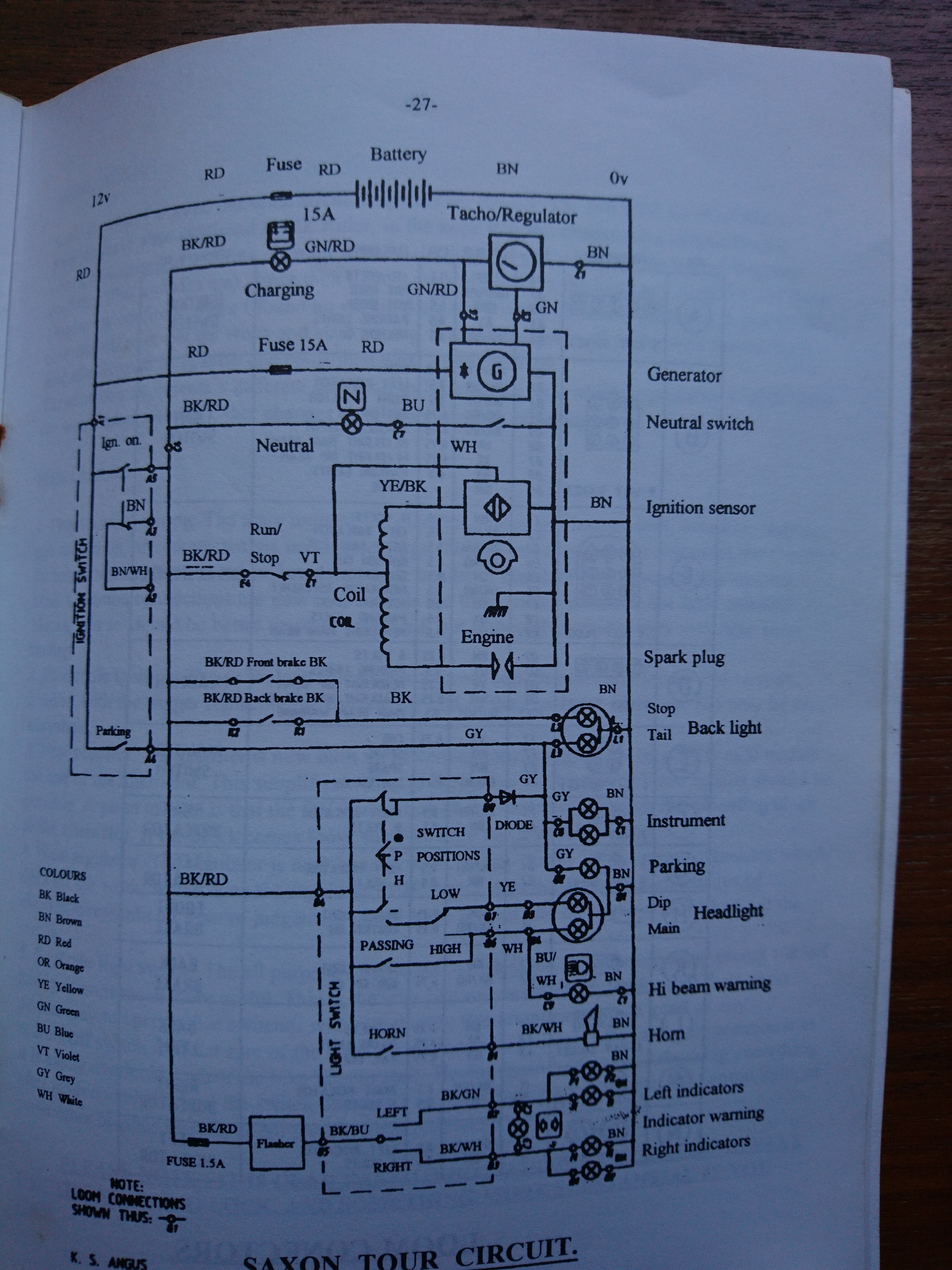

Are these of any help? (acknowledgements to KS Angus).
There is a violet wire from the kill switch, but no relay as far as I can see.

Postby DAVID THOMPSON » Fri Jul 31, 2020 10:04 am
:smt006 be careful some bikes of all different brands are wired other than the drawings
to meet the spec. of the country they were shipped to for sale

Hi Dave,
Thanks for the info, I actually have the same, it suggests that the violet wire connects to the coil, but I don't think it is the same coil as I am using. I feel it is a standard coil that connects to contact breakers and sparks. I think the one I am using is called a solid-state coil and the violet on the relay witches to a blue to the coil. That's how it is on my running Saxon (as I bought it) I am tempted to join the violet to the blue and do away with the relay because when I switch the run/kill to run, it of course switches to the coil via the relay. I had a delivery of 5M of brown 1.5 this morning so I can now add the ground wires in the right colour and reset the loom and aux. into their right places etc. (neaten it up a bit). Anyway, not too much to do now, Tank, seat, Carb, Dot 4 into front brake and reg number plate and keep me fingers crossed, a ring ding ding, then MOT. At least with this virus, it's made this old faart get his finger out a bit.
