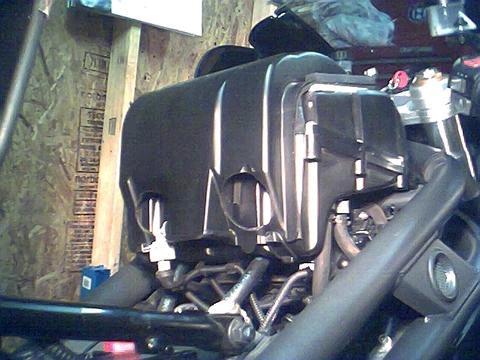

You might also want to open up the airbox cover. The air intake opening is very small, restricting airflow. Some have removed the cover, I left it in place but drilled holes in it so there's no major increase in intake roar as there is with it removed. Back when the 1000S was first up for sale here in the states I talked to a man from the distributor who said removing the cover would gain around 8hp and help smooth things out. After drilling holes, changing sprockets, different pipes, etc I've got to say I don't see any of this particular problem with the bike. Vibrates some, yes, but snatch of any significance? Not that I can tell (it's a whole lot better than stock) Other than that, I guess it's "Character" :-D

To be honest I could have lived with my bike as it was but I can never resist trying to make things just that little bit better :) Balancing the throttle bodies and changing sprocket has improved the bike at very little cost, so was worth the effort. It will never be turbine smooth but that's the attraction for me. If I wanted smooth I would have stuck with my Fazer 1000. It will pull from 20mph in top all the way through to 165mph without any hesitation or snatch, is blindingly fast but soulless. Since I bought the MZ I've only been out on it twice and will probably sell it in the next couple of weeks, so I think that says a lot for the MZ.
That’s a good shot of your air box mod, which will be my next step along with the Remus cans. The only other thing I'm tempted to try is the TuneBoy software (http://www.tuneboy.co.uk) and having it re-mapped to see what happens. It looks interesting as you can use it for engine diagnostics as well as tuning.

if you drill holes in the airbox as per the picture above, will the ecu automatically compensate for the fueling or do you require a powercommander :?:

Postby LWS66 » Mon Nov 17, 2008 7:38 am
I believe the ecu is a closed loop system and won't compensate for the increased free breathing.
Yet, I'm not running a Power Commander, have'nt had re-mapping done, and it runs fine, not popping on deceleration, no flat spots/hesitation, surging or anything that I can tell would mean it's lean. My plugs and exhaust look fine, definately towards the leaner side, but not lean. I'm sure doing the above would help, but it seems to be right at the fine line of needing to do that. If there was a proven map for my setup (open airbox, K&N filter, Sebring Twister w/baffles in/out, gearing change etc, I would probably do it, but being there's not, I'm not into buying a Power Commander and flogging it on a dyno.....for now. Maybe someday :?
