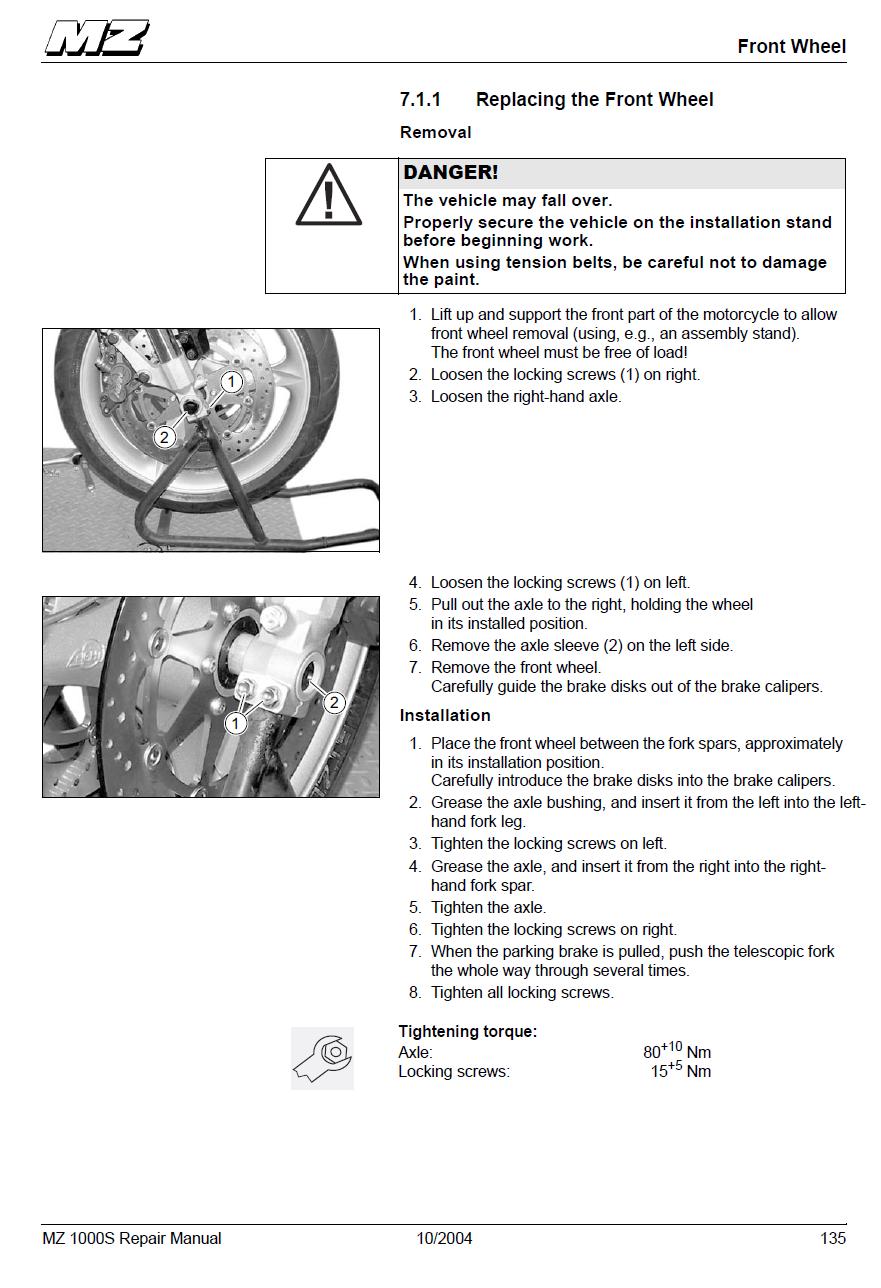

I removed the calipers to take off my front wheel today and ran into this problem.The axle bolt is threaded on the left hand side.How do you hold that ?
Pinch bolts loose and the axle bolt just spins when I turn the right side nut. see picture,thanks,john I can't read German and can't locate my CD...HELP

by tomtom
keep the left hand pinch bolts tight until you undo the nut on the right as its just a sleeve on the left side.
from manual
Lift up and support the front part of the motorcycle to allow
front wheel removal (using, e.g., an assembly stand).
The front wheel must be free of load!
2. Loosen the locking screws (1) on right.
3. Loosen the right-hand axle.
4. Loosen the locking screws (1) on left.
5. Pull out the axle to the right, holding the wheel
in its installed position.
6. Remove the axle sleeve (2) on the left side.
7. Remove the front wheel.
Carefully guide the brake disks out of the brake calipers.

by djsbriscoe
Hi,
Picture of page from manual
1000s Front wheel removal
David.

Tom,David,
Thanks a lot that helps me out.I did re-tighten the pinch bolts on the left figuring it would hold it .But when it wouldn't budge I stopped and looked at my German book. :shock:

by boilermaker
Iceman/John
