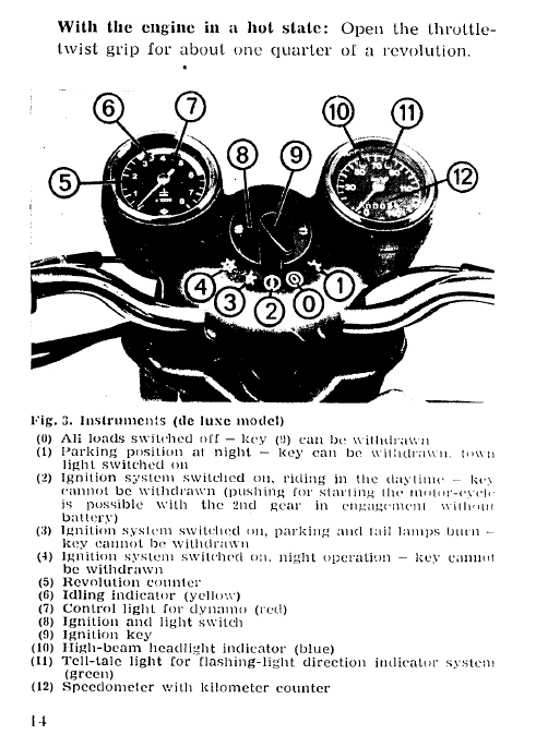

The ignition switch is a bit confusing though. There seems to be 6 positions with 5 & 6 both lighting the ignition light - and the speedo & rev counter illumination too. What the heck do they all do and which is best for starting and running? I get a spark using 5 or 6.

Postby Puffs » Wed Jul 08, 2020 5:21 am
Re: TS125 ignition switch
Postby Blurredman » Wed Jul 08, 2020 5:35 am
Hi,
As puffs says:
This should be of help. It's for the ETZ, but the switch positions I believe are all the same :-D

Postby Norrie » Wed Jul 08, 2020 10:49 am
Thanks for the quick replies and helpful nuggets of information, I'll go and count again!

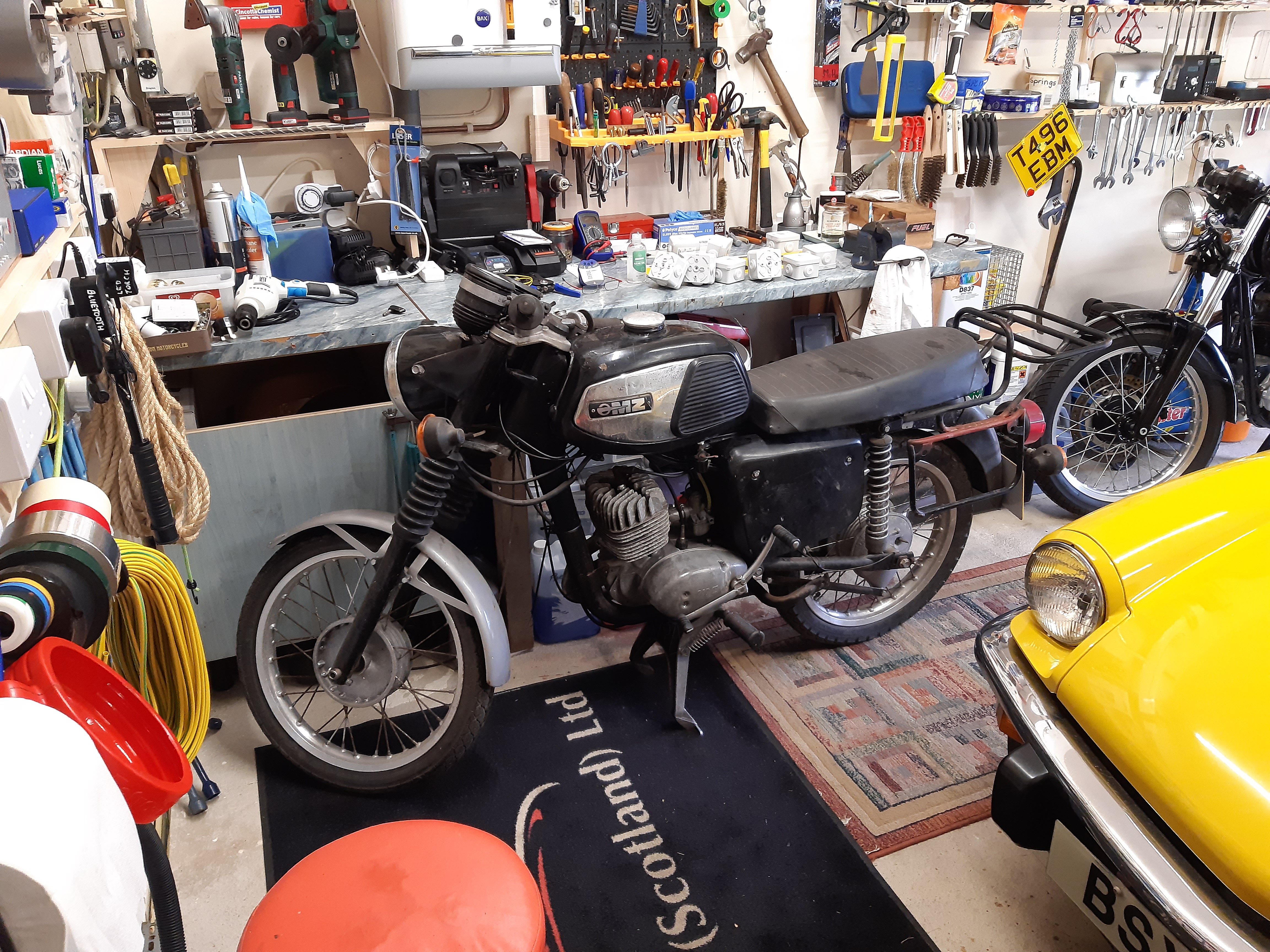

Postby Norrie » Wed Jul 08, 2020 11:01 am
Hope this works

Postby Gerryman Ts125 » Sat Jul 11, 2020 3:25 pm
Switch positions for a Ts 125-150 are (on a clock face) six o'clock. ignition on. Five o'clock. everything off. Seven o'clock. sidelights. Eight o'clock. diplight. Four o'clock. parking side lights. Three oclock starting with flat battery

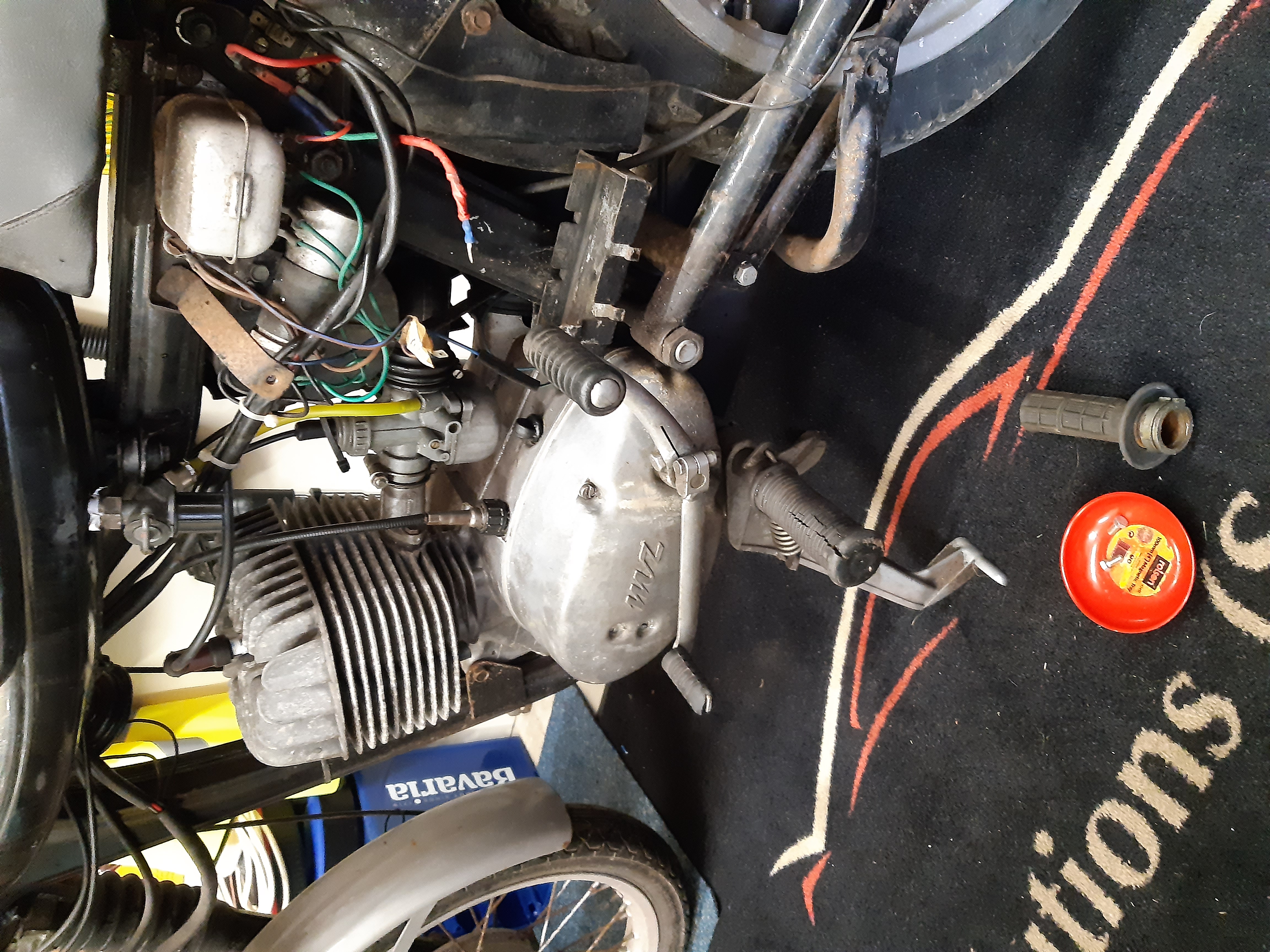

Everything seems to be working - I've fitted the new battery and had the carb off and given in a good clean...and it runs! Given my ham-fisted ineptitude that's really quite surprising.
I need to source a clutch lever and possibly a throttle twist grip too, then it'll be complete. But I've moved house and running out of garage space (it's bike number 5 and there's a couple of old cars in there too) so I may have to be open to offers.
If anyone's interested give me a shout.
