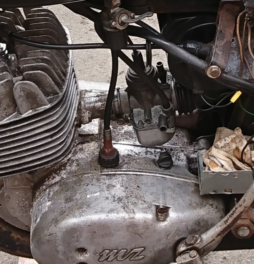

My new150 won't idle. There's only adjustment screw, on the left hand of the carb. It isn't right under the throttle slide, but further back. Nor does it go in at an upward angle. Turning this screw has no effect on the idling speed.
There is no other screw on the carb.

Postby Kruh » Thu Feb 18, 2021 12:28 pm
The screw colser to the filter adjust the idle mixture (amount of air).
A quick look at some pics, clearly shows the idle screw. Perhaps, the screw is missing, the head is damaged or its just plugged up.

Postby JawasandMZs » Thu Feb 18, 2021 1:56 pm
Oh everyone, have found how to adjust tickover. Turn the screw at the top of the carb anticlockwise so the needle sits higher in the carb. Easy as that!!

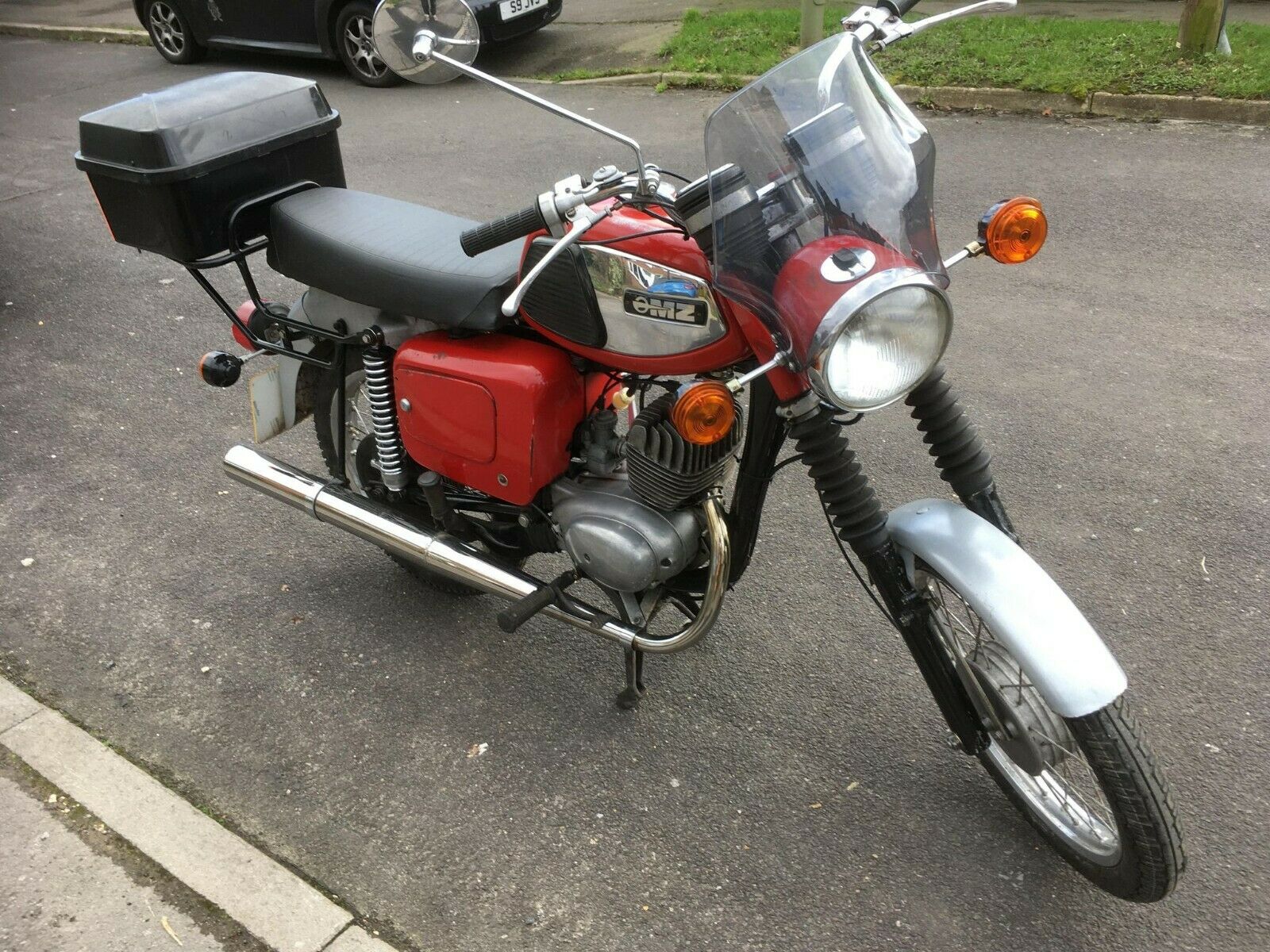

Postby Gerryman Ts125 » Fri Feb 19, 2021 8:10 pm
Ts carb tick over adjustment is the recesed one below the throttle top (in line with throttle cable) the one besides it is the air mix. Some Ts models before 1975/76 had no tick over adjustment.
The picture is of a 1986 model.
