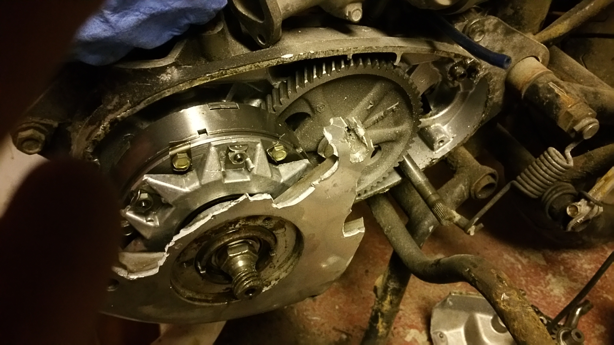

Postby Numnuts » Thu Jan 24, 2019 6:46 am
Hi
I know this is a pretty ancient thread, but I have the same problem.
The clutch cover comes out 4-5mm then refuses to budge.
Can anyone help.
Numnuts
Posts: 3
Joined: Sat Oct 27, 2018 8:59 am
Re: TS250 supa 5 clutch cover removal
Postby Numnuts » Thu Jan 24, 2019 7:57 am
Tacho drive nut DOH!!!!!!!
Numnuts
Posts: 3
Postby therealche » Sat Feb 02, 2019 12:44 pm
At least you realised before it ended up like this!
therealche
Posts: 700
Postby Puffs » Sun Feb 03, 2019 5:16 am
Ouch!
