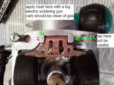

I'm trying to remove the float retaining pin on my Skorpion Teikei carb.
Stuck Teikei float pin
I'm assuming that the pin should be removed in the opposite direction to the little arrow on the casting, am I right?
Does anyone have a non distructive way of removing the pin. Otherwise I will just have to leave as is.
As always any help appreciated.
David.

Postby DAVID THOMPSON » Sat Apr 24, 2010 4:58 pm
see picture i added arrows to
but not to hot and dont tap to hard
do not want to break the posts

In addition to Dave's good advice, I'd suggest get a helper to support the carb boss vertically on a small (5mm or less) deep socket, metal tubing or whatever on the as-shown left side to absorb the force and allow the pin to push through.
Then use a thin (under the pin diameter) punch to gently tap the pin out. It's critical to avoid having the float pivot areas take the force unsupported.
Typically a four handed job, to play it really safe.
Good luck.

Note that you should be trying to remove the pin 'IN THE DIRECTION OF THE ARROW' according to the manual. Take great care when removing it as it is possible to break off one of the mounting lugs. (Don't ask!) I've used a small nail with the point filed flat to make a punch to drive the pin out with VERY light taps with a small hammer.
Good luck.

I've used a pair of electronics wire cutters to grasp the pin. Works great but it tends to score the pin slightly, but it should be ok with a bit of wet and dry or dressed with a needle file.
David.

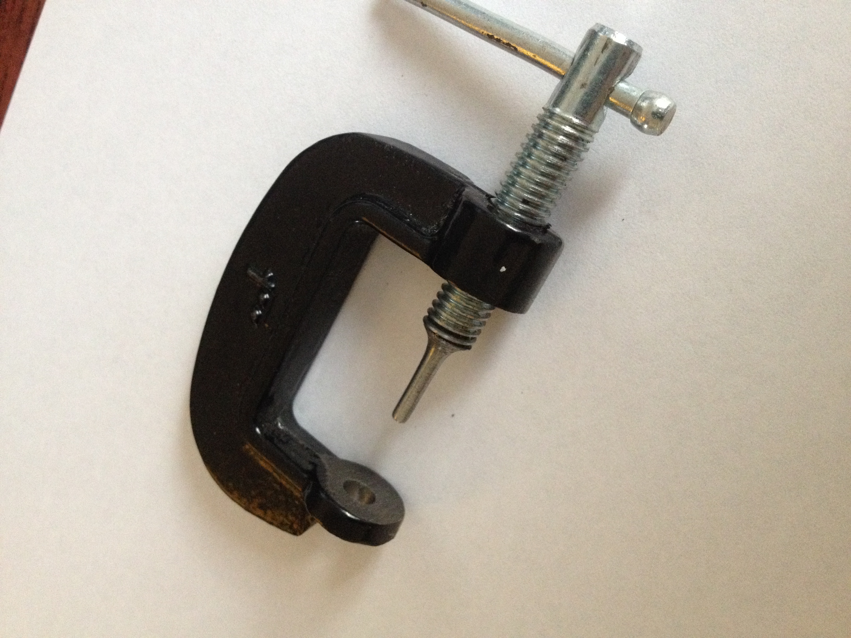

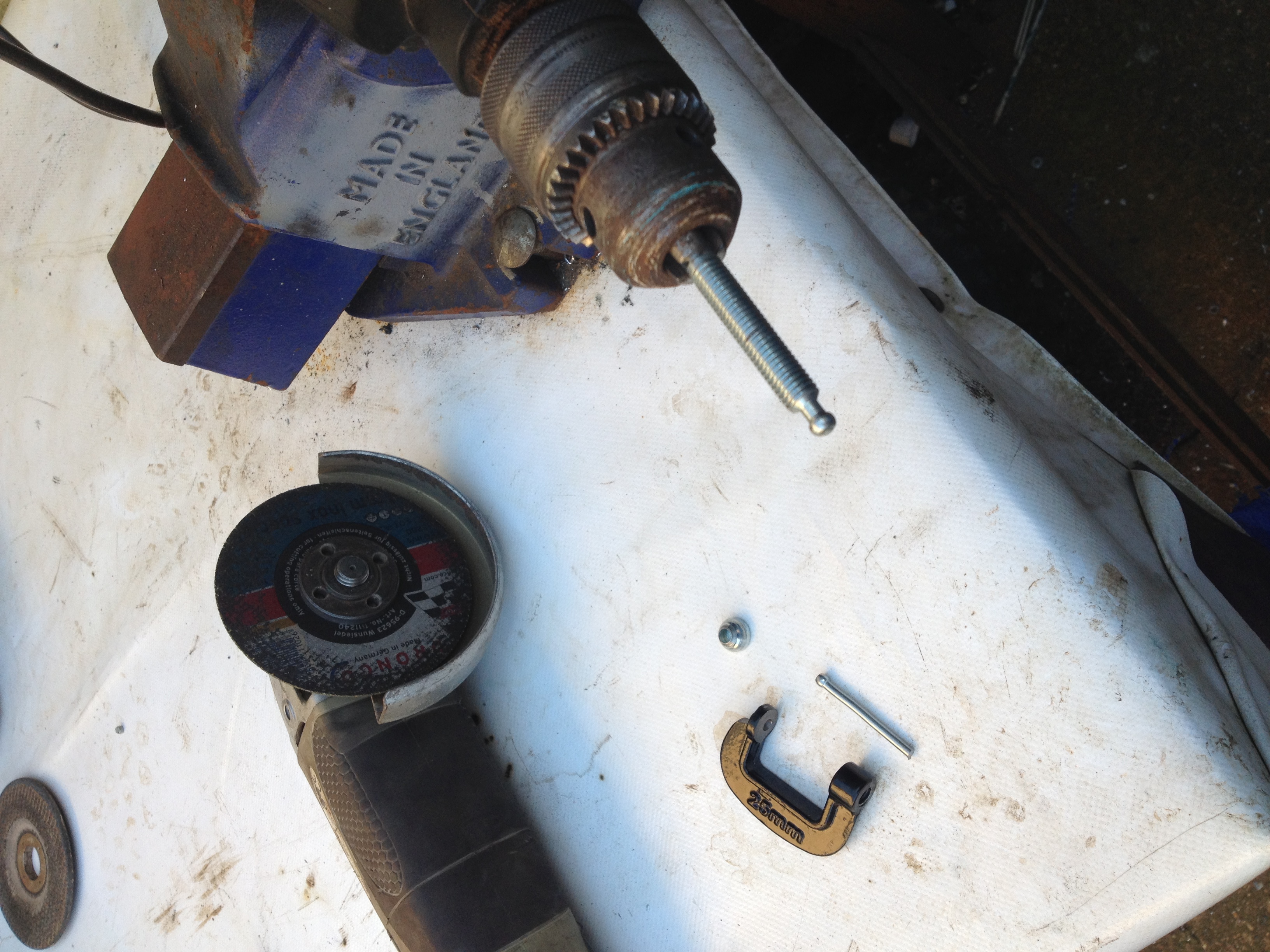

ok , so i pondered over this problem because i had the same issue myself not so long back,,love solving problems and i think i found cheap home made "carb float pin removal tool"
as you can see in the photo its a modded 1" G Clamp..here are instructions to make your own,,
1.buy steel good quality g clamp
2.file flat the opposite to screw end to allow pin to pass through..
3.wind out screw to prise off pad.
4.wind screw back in to make mark on opposite end ,ready for drilling.
5.remove screw and through that hole drill hole for opposite end to allow pin to pass through
6.remove t bar from screw and place in electric drill.
7 .rotate screw and file end to make pin push shape,i used grinder. file will do.
8.replace t bar and squash end so it keeps
9 stand back in amazement at your new toy,
