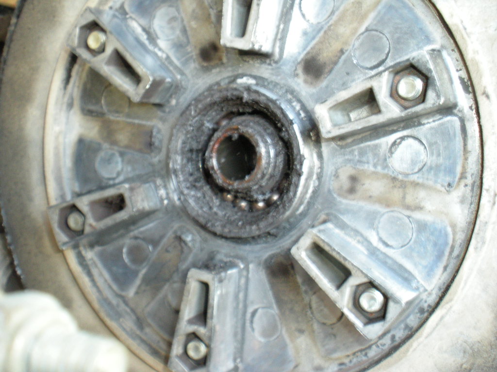

I just got around to replacing the rear tire. Took the wheel off and bits of metal fell out on the chain side of the rear axle. Turns out that the bits of metal were parts of the cage of the bearing that lives in the sprocket. Is this a common bearing. Anyone know the cross ref for this?

Yep, common bearing. I just replaced mine. It's a 6302-2RS or 6302-2RSH (neoprene rubber skirts). Best quality brands are SKF or INA.

You're welcome Ryan. FWIW, the outer cages on my rear wheel bearings looked about like yours. I think you got to them just in time as I did. :-D How does the cush drive rubber look? Mine was fine. The manual recommends cleaning it up then douche it down with a lubricant when reassembling. I used a silicon spray and it worked well.

I've got to thinking on why this bearing failed like it did. Maybe the lithium grease that I packed in the chain tubes pushed out the hi temp wheel bearing grease that I had packed in it when I changed the tire last. Or, do these bearings require a maintenance schedule in the hundreds of miles not thousands? I can't find any interval figure for this bearing in any of the books that I have. Maybe I should just make it a routine to pack this bearing every so often.

The originals are open bearings, thus require periodic maintainance, that's why I went with the sealed neoprene bearings. I'm lazy.......... :-D

The 6302-2rs bearings came in today. It looks as though they are the bearings that fit in the wheel itself (in the brake drum). Do you happen to know the number for the bearing(s) that are pressed into the sproket housing? The ones next to the speedo drive gear.

The sprocket housing bearings are the 6004 series. Replacements are either the sealed 6004-2RS (2 rubber seals, preferred) or 6004-2Z (metal seals).

got the rear wheel on. New tire, bearings, sprockets and chain later. I've noticed the bike tracks straight as new now and no jumping speedo needle at speed. That must be a warning signal that the rear bearings are about shot.
The rear axel bearings are no big deal. It helps to have a bearing press though.
