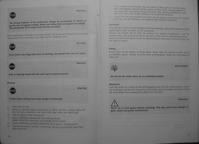

Postby metric » Fri Nov 16, 2012 7:49 pm
Here is a picture I took of the relevant pages from my English language Silver Star owner's manual:
I hope it's legible.
I think this is the first time I've read it closely; it says to start the engine with the valve lifter lever pulled. This is not the procedure I've been following, since I don't believe the engine will start without compression. I checked the German language version; the relevant passage says, "Soll der Motor mit dem Kickstarter gestartet werden, die Kurbelwelle vorherauf den oberen Totpunkt stellen. Dazu den Ventilausheber betätigen,den Kickstarter vorsichtig nach unten treten, bis im Schauglas am Ventiltriebdeckel (Bild 5) die weiße Markierung erscheint. Bei eingeschalteter Zündung und nochmals gezogenem Hebel für Ventilausheber den Kickstarter kräftig durchtreten." Again with the valve lifter pulled. Very strange.
My procedure is to pull the valve lifter whilst turning the engine slowly with the kickstarter, peering in the little window for the white mark. When the mark appears, I close the valve lifter (release the lever), reset the starter pedal and "depress the kickstarter forcefully".

Postby DAVID THOMPSON » Fri Nov 16, 2012 7:58 pm
on mine the lever clicks off a bit before tdc so it has some compression but if it fires it is usually past tdc
and hopefully does not kick you back
Posts: 5152
Re: Small round window...
Postby metric » Sat Nov 17, 2012 9:20 am
Thank you for the clarification, David. All this time I did not understand that one "cocks" the decompressor and that it then turns itself off. I thought that the lever's staying in the decompressed position with the control released was a problem; now I see that it is a feature.
Is this how you use it with the electric starter as well? My procedure is to pull the decompressor and hold it, then press the starter button. When the engine has turned a few revolutions I slowly release the decompressor and the engine starts. When stopping the engine I pull the decompressor, then switch off the igniton once the engine has stopped.
I look forward to trying this new method of kick starting, though the motorcycles here have just begun their hibernation.
I don't intend to make a habit of kick starting the Silver Star, but I like knowing that I can do it efficiently if I wish to.

as the cam moves the release is on the exhaust valve and there is a point it kicks off by its self if adjusted proper
on the electric start i hold it and let it off after the starter has the motor up to a good speed ..
this way the weight of the crank helps the starter
i always stop it with the decompression lever so motor does not run backwards against the starter sprag clutch
then turn key off
