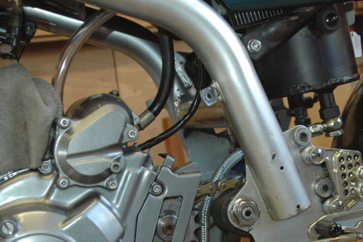

Since my racer had no starter, you can see the original hose with crimp at the top right:
My racer used the original plastic tank. I had not gotten smart enuf yet for the round one I now use.

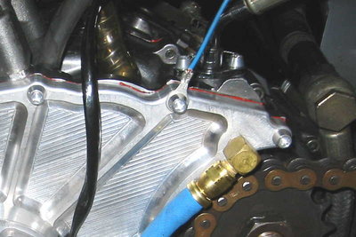

Even so, I am still using the same original oil return line with crimped fitting:

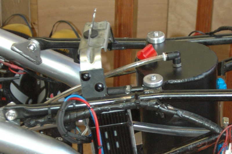

and the tank is still a push fit with clamp;
the clear line is the pressure balance line, the one of plain rubber hose entering your tank next to the return line.
The much larger clear hose in the foreground is the breather line back to a catch tank since I do not have an airbox.
