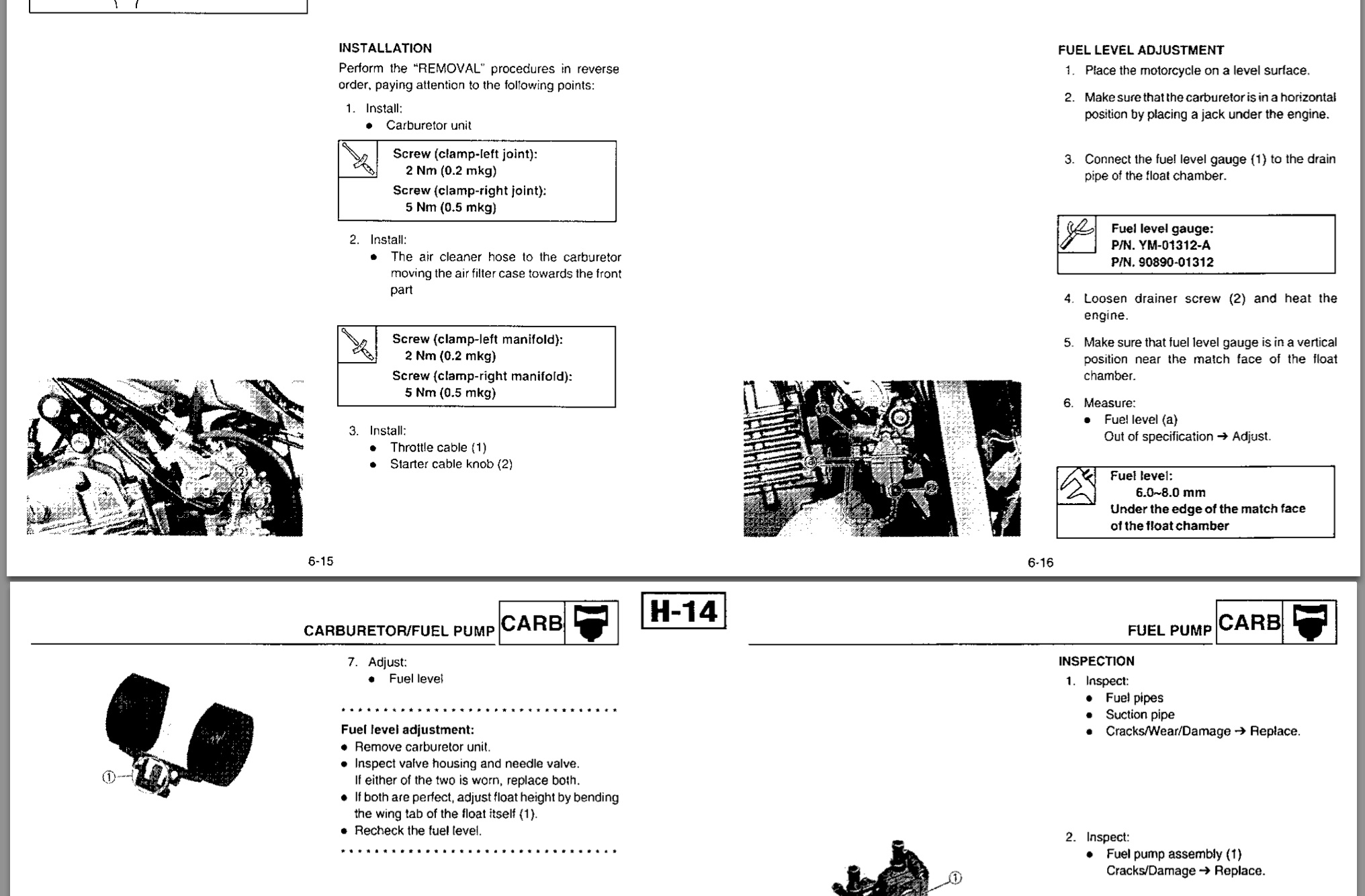

Let me get ahead of myself a bit... After I have cleaned the carb, how do I ensure that fuel level in the float chamber is per specification?
I am using the 1995 SZR660 Service Manual as guide. This procedure presents a challenge because I do not have a suitable jack for the bike, and I don't know if it's really necessary to buy a $40 (ebay) fuel level gauge.
What do you think?

Hi I am currently cleaning up the carbs and setting the float hight.
You can read my post Scorpion Tour looses power after 2 km drive
Now a member was kind enough to tell me that the height of the float bowl should be between 25 - 27 mm.
Mine is 30mm so I had to adjust it.
You need to take the carburetors out unscrew the float bowl cover ( 4 screws )
With the carbs right way up push the floats up untill the needle just closes the fuel inlet. You need to careful since this needle has a loaded springy button. It closes just as it does not travel up and just as you slightly load its springy button.
Measure the distance between the bottom of the black plastic float and the mating surface of the carburetor to the float bowl cover.
adjustment if required is by bending the tab that pushes the needle.

otherwise you can pack wood under the engine to bring it level, and attach a clear flexible plastic hose and measure it with a good ruler ;)
it will cost next to nothing

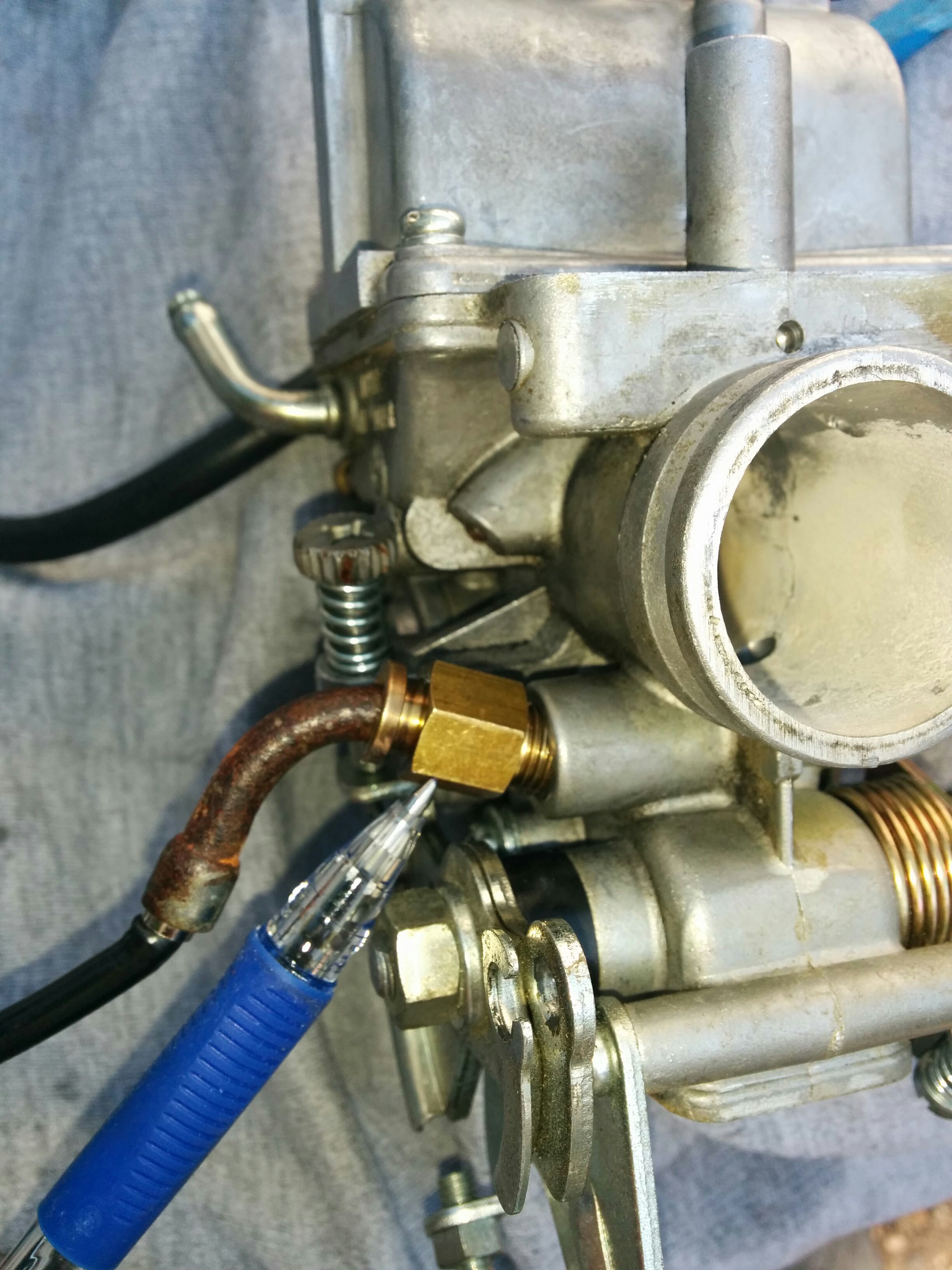

edfmaniac wrote:And yes, if the brass nut is backed off the threads all the way, the choke assembly should pull out fairly easily.
Hate to be going back to the same issue... But as you can see from the pic, the brass nut is completely unscrewed - I can even pull the nut 2 mm away and see the spring inside. But I am afraid to pull or yank the brass nut further, for fear of damaging the spring.
How should I proceed? Do I continue by unscrewing the elbow tube itself? Thanks again for all the help.

Postby DAVID THOMPSON » Thu Sep 17, 2015 10:43 am
a good soak with sea foam is next
and if that fails then a modest amount of heat and then cool several times on the aluminum part DO BE CAREFUL
clean all the fuel out of it and the flame from a small candle on the aluminum part to make it expand a bit several times.

Postby WaiNYC » Thu Sep 17, 2015 10:50 am
After soaking in sea form, do I just pull the brass nut loose? or continue by unscrewing the elbow tube?
Thank you again.

Postby edfmaniac » Thu Sep 17, 2015 11:16 am
Once the nut is loose, as shown in the photo, it should slide right out. It's obviously stuck so soaking is about all you can do. I don't see heat doing much in this situation because it's likely corrosion causing the binding. It might help, but I think penetrating oil(PB Blaster), time and some force is about all that will get that plunger to come out.

Postby DAVID THOMPSON » Thu Sep 17, 2015 11:17 am
it just slide in there and gets corrosion needs silicon oil regularly
have had it happen before on a Yamaha 250
its a very tight fit to begin with and a common problem on these carbs

Postby breakwellmz » Thu Sep 17, 2015 1:56 pm
Isn`t it a brass plunger that is stuck in the body that hangs on the cable end? A good couple of days soaking in `Plusgas`is a good start.
A mini blow torch or lighter is more efficient than the candle to break down the corrosion. or an oven at about 200C frees most things.

Postby DAVID THOMPSON » Thu Sep 17, 2015 6:25 pm
checked at my local shop he had a listing for the brass thing
so drilling it out is an option
with the word "carefully" as the key word

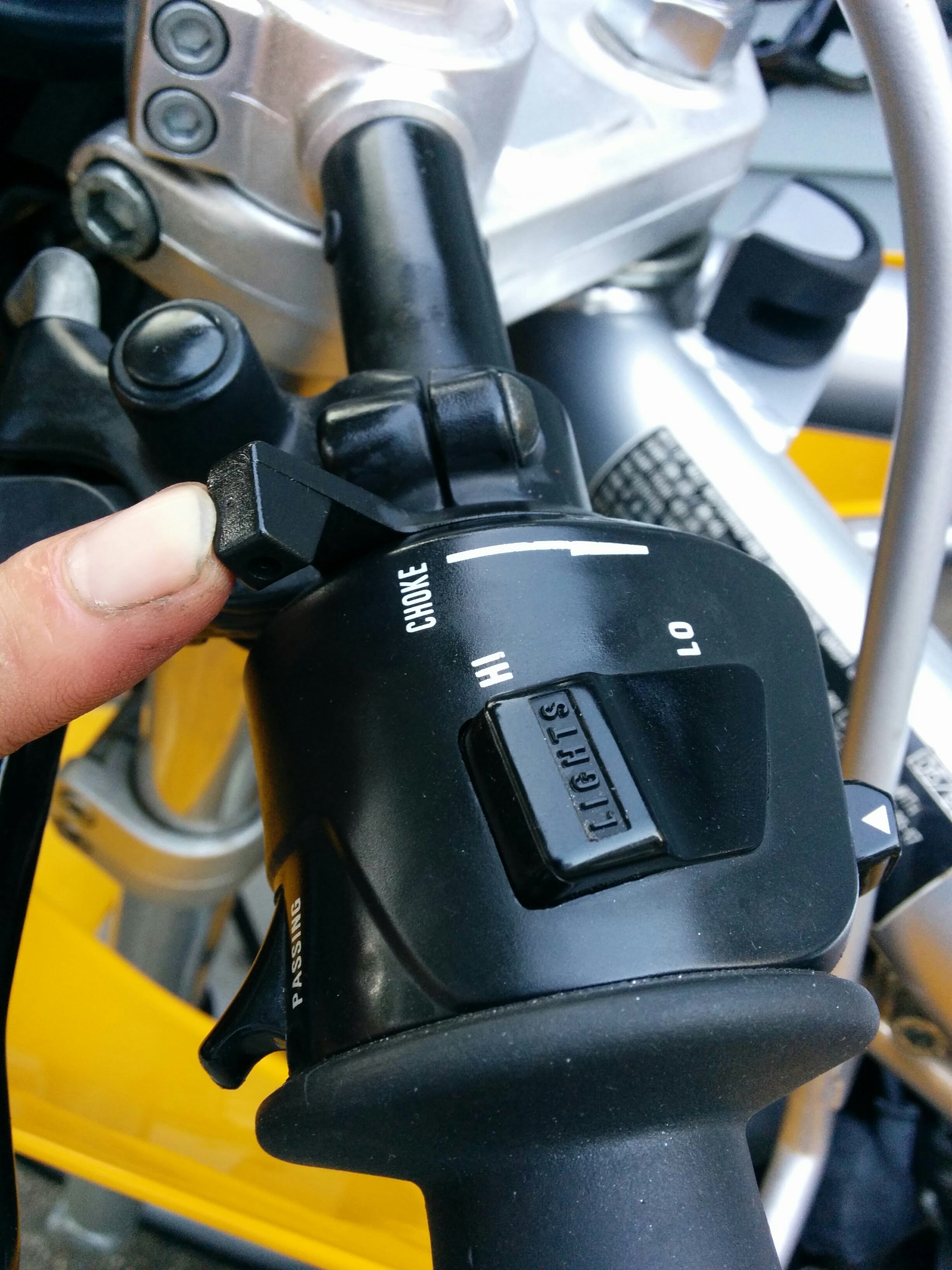

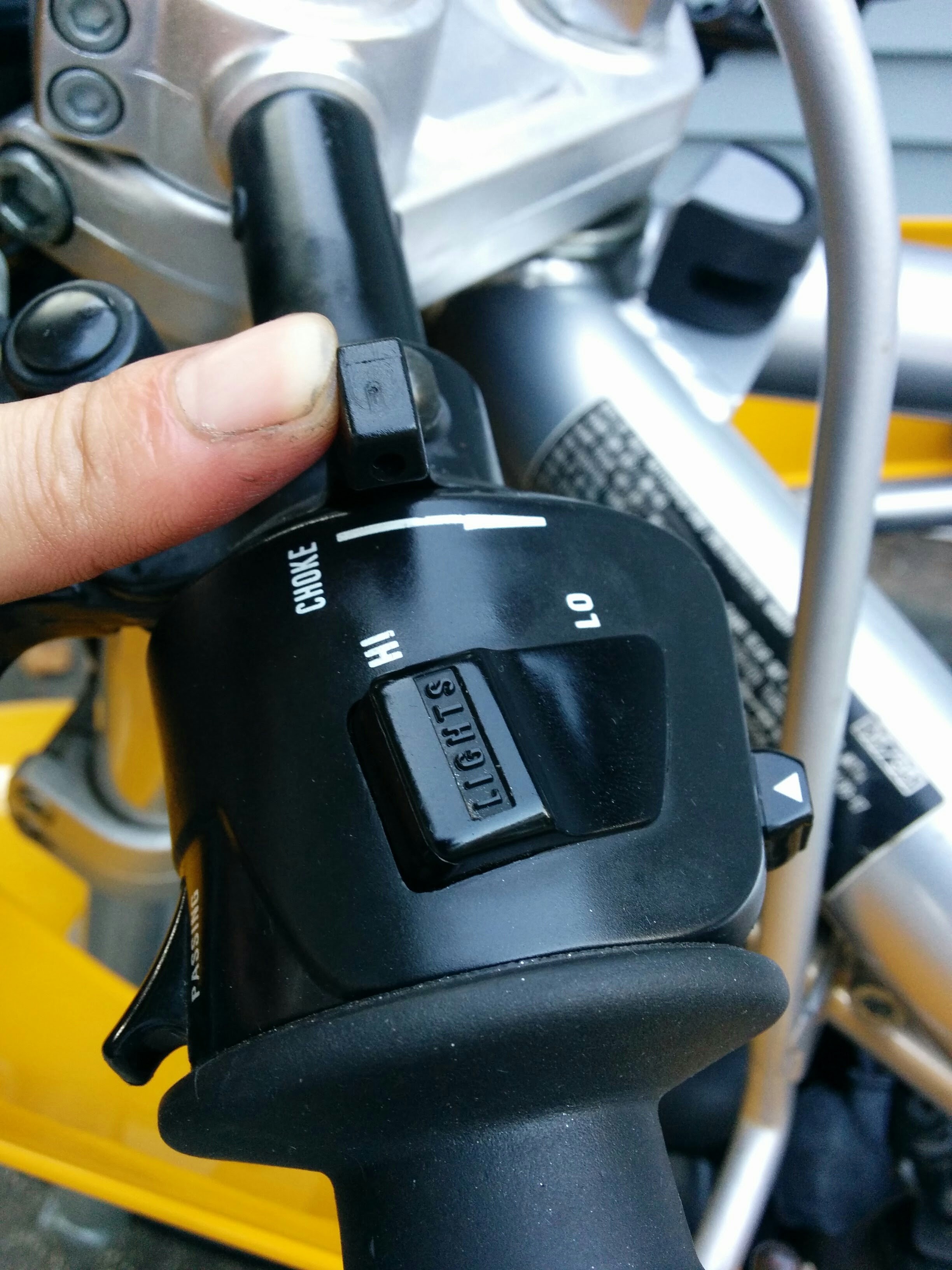

The choke cable is still bugging me :cry:
I have an addition piece of information to add. The choke lever is actually quite tight. Even before I started taking the bike apart, I had noticed that the choke lever could not move all the way. This is not normal, isn't it? Do you think it has anything to do with why the choke cable is stuck inside the carb?
Choke lever, at disengaged position
This is as far as the lever will go

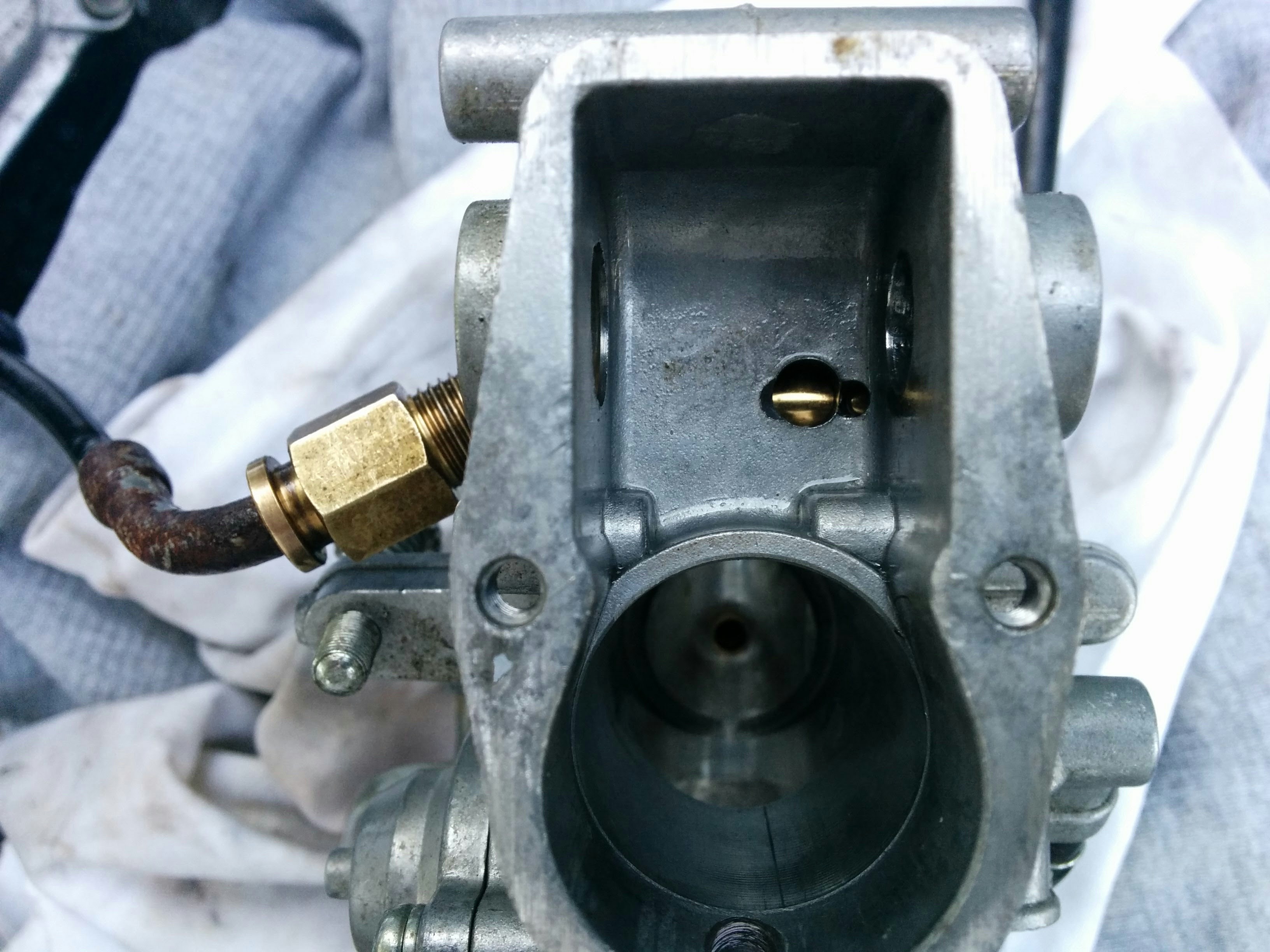

Additionally, there is a brass object behind the chamber that houses the throttle valve, which seems to lie on the same axis as the brass nut (and choke cable assembly). Do you think it is something I need to push or wiggle to get the choke cable out?
