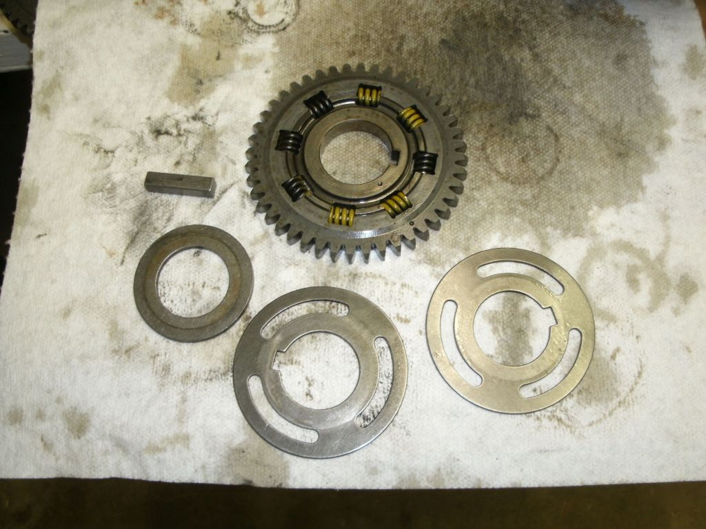

Postby den » Tue Mar 19, 2013 2:36 pm
im about ready to do the gear mod myself and now you have thrown another spanner in the works ,
please explain what you mean by this ,
"remove the two vented washers and the thick solid washer when doing this mod."
Didnt know i had to do this aswell , replace with what , more new parts?? :oops: :(
den
Posts: 509
Location: leicester

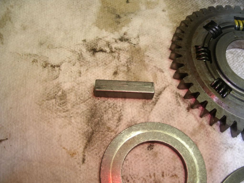

Postby edfmaniac » Tue Mar 19, 2013 6:56 pm
The solid gear replaces the sprung gear and all three washers in the picture. Don't forget to put a new key and lock washer on when you reassemble. They are cheap. My key had the slightest evidence of wear but I bet they go south quickly once you can start to see the damage. One other thing to remember is that the marking on the balancer gear won't line up with the one on the solid gear. You'll have to count how many teeth away from the key way that the dot is on the original gear and orient the solid gear in the same position.

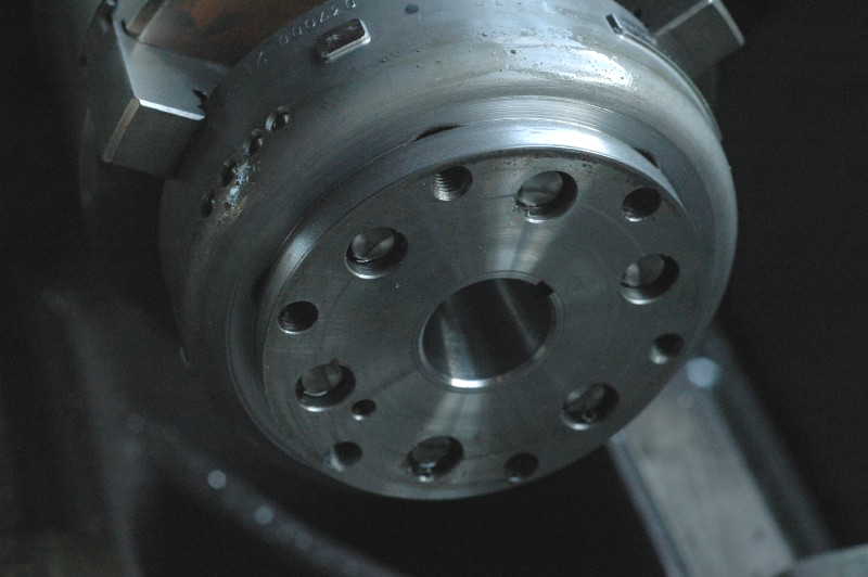

to disassemble the flywheel, heat it up on a hotplate to break the Loctite on the three bolts, then remove them with an impact driver.
The flywheel itself can be turned down as far as you want as long as you leave the center section reasonably intact for bolting the freewheel on.
I usually leave about 1mm standing to center the freewheel but you can go further down. Then you must assemble the entire thing on the crankshaft to get it centered, then taken it back off as an assemble and reinsert each bolt separately with Loctite 242 and finally peening the end of the screw. With the lip left, you can assemble the thing and be done with it. Whether the addition few ounces are really that important is questionable Admittedly, My own private use flywheels were done that way.
The freewheel is another matter. It is casehardened and so can only be turned with tungsten carbide cutters at low speed. It is time-consuming.
You can see the difference in hardness. You can turn this part down to the shoulder that fits the recess on the flywheel. You cannot leave like that, however.

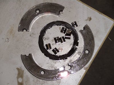

This is not one of mine, but it show what happens when the ring is left that thin.
I will continue with the ring on the next posting since one is limited to three attachments.

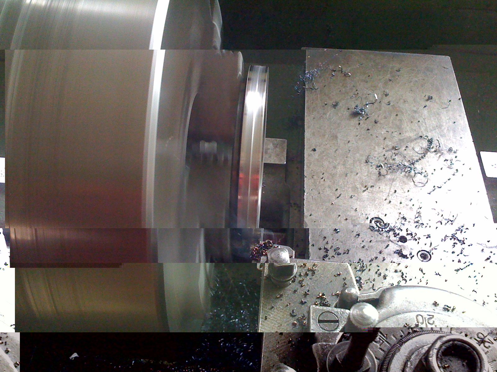

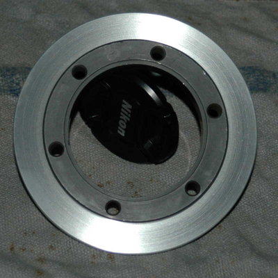

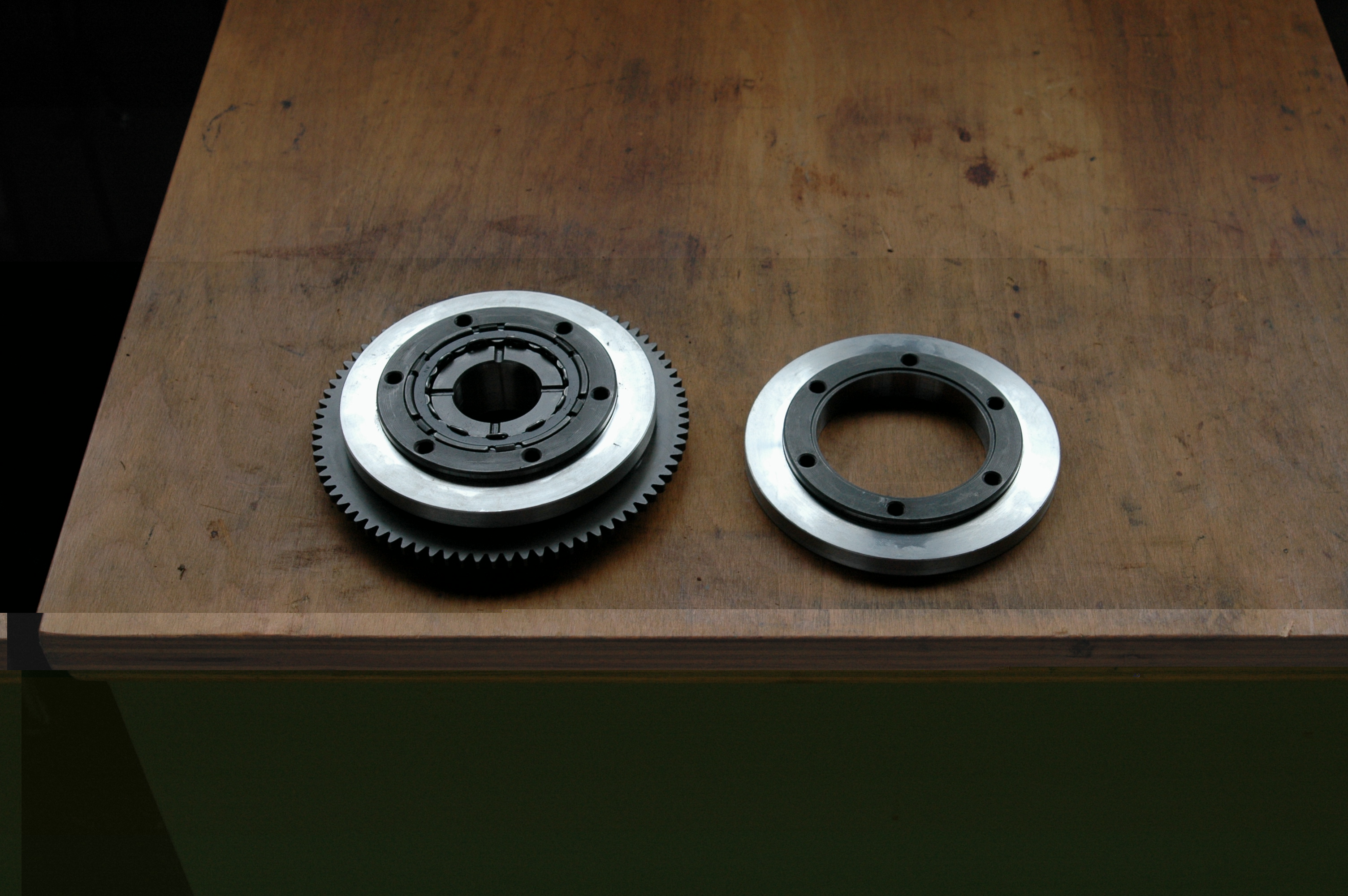

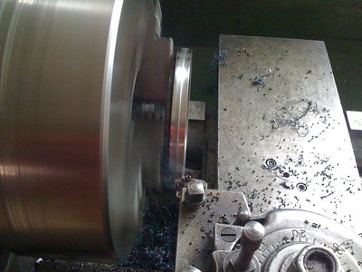

Postby Bill Jurgenson » Sun Mar 31, 2013 11:24 am
with the ring turned down, turn a ±140mm OD ring from suitable aluminum 11-12mm thick. Turn it out inside to -0,35mm and heat that to 250º C and let it drop over the steel ring. After cooling, you can turn the thing to its original size (always assuming you made a dimension sketch beforehand!).
Bolt the parts together as described and install exactly like the OEM part. Don't forget the Sprague clutch! And before bolting up, check to be sure that the clutch turns freely in the flywheel. Otherwise, carefully grind out the freewheel ring revolving at high speed in the lathe with an airgrinder and fine stone. Only just skim it. Usually it is not necessary but sometimes the condition of the ring inside is already soptty so a bit of smoothing does no damage.
All in all, doing the job properly is quite a bit of work, time consuming for which reason it is either not done at all or it costs money to have it done - or is it improperly done with the results shown above. Such burst rings are not so uncommon.
