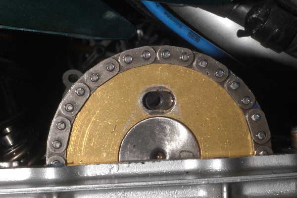

Another very real reason is being able to change the cam timing and setting it the accurate lobe center. To do that, you need a timing gear with slots so that the gear can be positioned:
this is my aluminum gear for the roller chain I use. Timing gears from the TRX are often used because they have enuf meat to be able to mill slots.

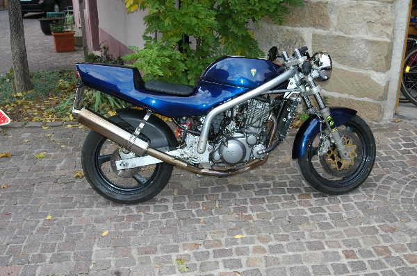

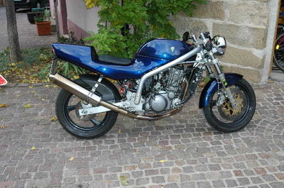

My (now reassembled and sold as hobby racer) blue Tour used its stock crankshaft and stock piston for over 70tkm of it life. I fit the 101mm Wiseco when the bore got too bad to take anymore. It did have a Megacycle 280-2 cam (without Deco) but used the stock springs and retainers with the original stock valves and guides which are still in there as it that 16 year old stock crank and conrod. This was the first engine I modified the flywheel assembly on. At 35tkm I removed the balancer, too. Careful porting, a halfway decent exhaust system
and a Mikuni brought this nearly stock engine to 59hp at the rearwheel. It was subsequently run like that until I sold it (over 80tkm) and is basically running like that still, albeit with a 280-4 cam, dual 38mm carbs, greatly lengthened intake manifolds.

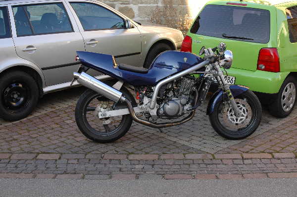

I sold it with the Remus Cup system shown below.
Point is, don't tamper with the engine internals until everything outside has been taken care of.

In the pictures above the blue bike has the TZR125 3,5/17 rear wheel with 130/70 tire.
