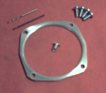

what *is* this thing?
why not just replace the 'swollen' diaphragm?
quote translated by Babelfish from
http://www.tunebike.de/Deutsch/Competit ... gaser.html :
For the MZ Serien vergaser: The carburetor kit for the compensation of the diaphragm swelling, which leads to power loss! At the same time the responsing mode is improved substantially, the motorcycle reacts many more spontaneously and more directly. Are contained in the kit adjustment instruction, nozzle drills, spacer ring, Stolperrohr and screws. Are continued to need (do not contain): Drill 5mm, silicone sealing compound. Several times with best results in series and Stufe1-Motoren tested. Nearly as well as a flat slide!

Postby keithcross » Wed Dec 07, 2005 12:58 pm
I think this ring clamps the diapragm in the right hand carb better. Not to sure though, try emialing Bernard at tunebike and asking him. He is a very helpful chap.

Postby DAVID THOMPSON » Wed Dec 07, 2005 5:43 pm
hello
it may be a spacer to adjust the diaphram so the slide is moved by the vacume to a better location for proper fuel and air mix

Postby cat » Thu Dec 08, 2005 12:57 am
keithcross wrote:I think this ring clamps the diapragm in the right hand carb better. Not to sure though, try emialing Bernard at tunebike and asking him. He is a very helpful chap.
Keith
i eventually saw their English translation, which was better. they say 'enlargement' of the diaphragm. your theory sounds good, but 'swelling' or 'enlargement' suggests the need for a new diaphragm. but the kit also includes jet drills and a replacement venturi tube, so there's more to it than just the diaphragm.

Postby Fil » Thu Dec 08, 2005 4:05 am
I think the spacer just moves the diaphram up a little higher in relation to the carb (I would guess it goes under the diaphram). I think the purpose of doing this to reduce the 'pull' on the carb slide (the bit with the needle in) as it moves higher up the carb. As the slide moves up (with wider throttle openings), the diaphram will have to stretch that little bit more, thus putting more resistance on the slide as it tries to move higher.

Postby cat » Thu Dec 08, 2005 5:19 am
Fil wrote:I think the spacer just moves the diaphram up a little higher in relation to the carb (I would guess it goes under the diaphram). I think the purpose of doing this to reduce the 'pull' on the carb slide (the bit with the needle in) as it moves higher up the carb. As the slide moves up (with wider throttle openings), the diaphram will have to stretch that little bit more, thus putting more resistance on the slide as it tries to move higher.
I could be completely wrong of course!!
<sigh> i was never good at carbs. i think EFI is much easier to understand. ..... by 'enlargement' and 'swelling' maybe he (the German writer) meant the stretching you're talking about. that makes sense. better throttle response / "more direct" ... the initial sudden opening of the throttle, the initial resistance of the diaphragm [before the pressure builds up] would be slightly less. but it would also - being slightly higher - make the mixture richer at the closed position. ? :-)
