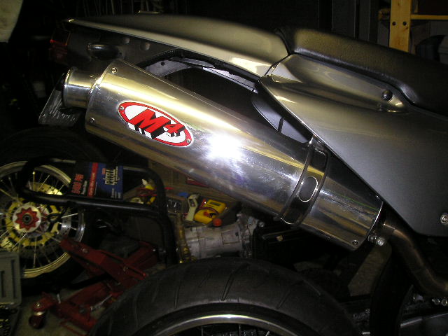

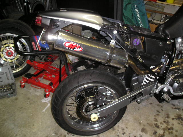

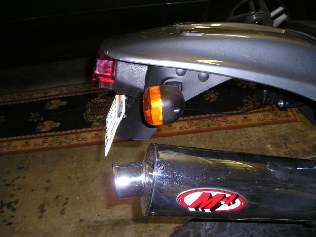

The M-4 Can I have is Part # MZ 6312 (listed for a Mastiff) Polished
MZ 6314 Is Carbon, MZ 6316 is Titanium...................The bracketing for the tall baggy (see my pic) sucks, the picture is what it will look like out of the box waaaaay too low, I changed the bracket moved it forward twisted and screwed around to get it up............now, the exhaust tip is right under my blinker, I just used my own bracket, (no bending or welding was done!!)If you want see detailed pict of what I did I will be happy to post the shot with side cover off etc etc etc :-D

Postby gedge » Fri Aug 06, 2004 4:16 pm
I still can't get mine up that high.. Can you post a picture of your bracketing etc. Might give me a clue where I have gone wrong :(

Postby Brian » Fri Aug 06, 2004 5:04 pm
gedge wrote:I still can't get mine up that high.. Can you post a picture of your bracketing etc. Might give me a clue where I have gone wrong :(
Sounds like a personal problem........ :smt044 I will take a couple shots of my bike and post them tonight our time....................when I did this I loosened all the bolts except the header bolts.... moved an twisted the whole can and mid pipe, (also slide the pipes closer together to get the angle) got it to where I liked it then tightened everything down.... its not the smartest way of doing it as I have some small leaks but they have always beens there, doesn't really bother me nor does the bikes performance suffer.........cheers

Postby Brian » Fri Aug 06, 2004 10:07 pm
hope these help..... I love the M-4, yup spendy, I gulped and paid the price... the mid pipe comes with as well.... Phlat has had success with his yammy can... for waaaaaay less....when I saw the baby m-4 (on the 125 cc) at a bike meet with Phlat the other night) I was thinking hmmm time to go two... the big bore racers have seperate exhausts.... they've done the research.....I know..... its enough to drive ya crazy...... I'm already scratching my head building my KX 500 SM racebike... Cheers :-D

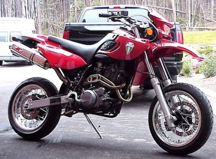

Postby Brian » Sat Aug 07, 2004 6:07 pm
~$~The Doctor~$~ wrote:yeah M4
Hey you chopped your rear fender !!!! 8) Holy crapoly I loooooove that color.... :o The DOT streets help the nervous front end don't they ? I dropped my clamps down a few mm's I might be able to get my hands on a pair of 48 mm Ohlin's Man I love that color !!!!!!!! dam sexy !!!! :-D
