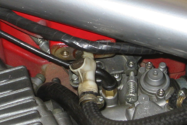

Remove the petcock entirely and check that the screen on it inside the tank is free. Then the petcock is notoriously too small to begin with. Drill it out carefully or get one fro a Baggi which is bigger. Or take it off entirely. I use a quick release connector with a 6mm hose.
quick release.jpg (67.41 KiB) Viewed 4421 times
You can't possibly be more "turned off" than completely disconnected and it makes removing the tank a hell of a lot easier. Not so much having take of the hose each time as fumbling,forcing the big petcock past the harness in and out. This is not good for the harness at all.

Question on the picture.
Is that quick connect ( male side) just epoxyed into the tank? In the past you mentioned using a Aprilia part that would replace the stock peacock, do you have a picture or part number? I recently installed a universal Arebac (sic?) peacock that was a little smaller in profile and diden't drag on the wiring harness as much but it's still not perfect.
Thanks
Doug

by Bill Jurgenson
Hi,
that is the Aprilia part. It has 3/8" (??) pipe threading which I tapped into the tank, not quite all the way so that the thread cinches up.
I do not have a part number for that tho I can try to find out. My friend and Aprilia dealer has them on stock so there was no need to order.
I fitted thre or four tanks with this one and two with a home-made hose fitting of brass soldered from an 7mm tube and a flange to use the existing bolt holes. The flange has a recess for the O-ring. These two use in-hose quick releases.
In all cases I adapted the filter screen from the original petcock onto/into the new fitting. Obviously, there is no reserve.
