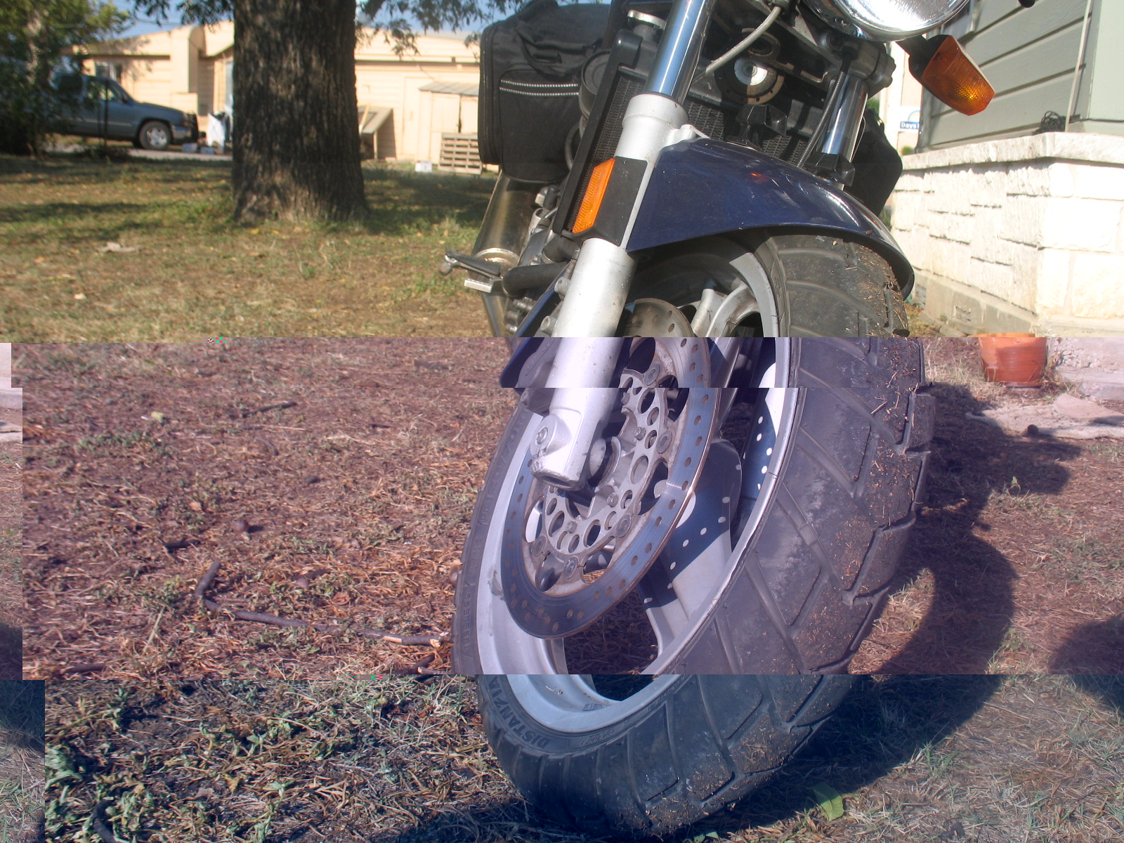

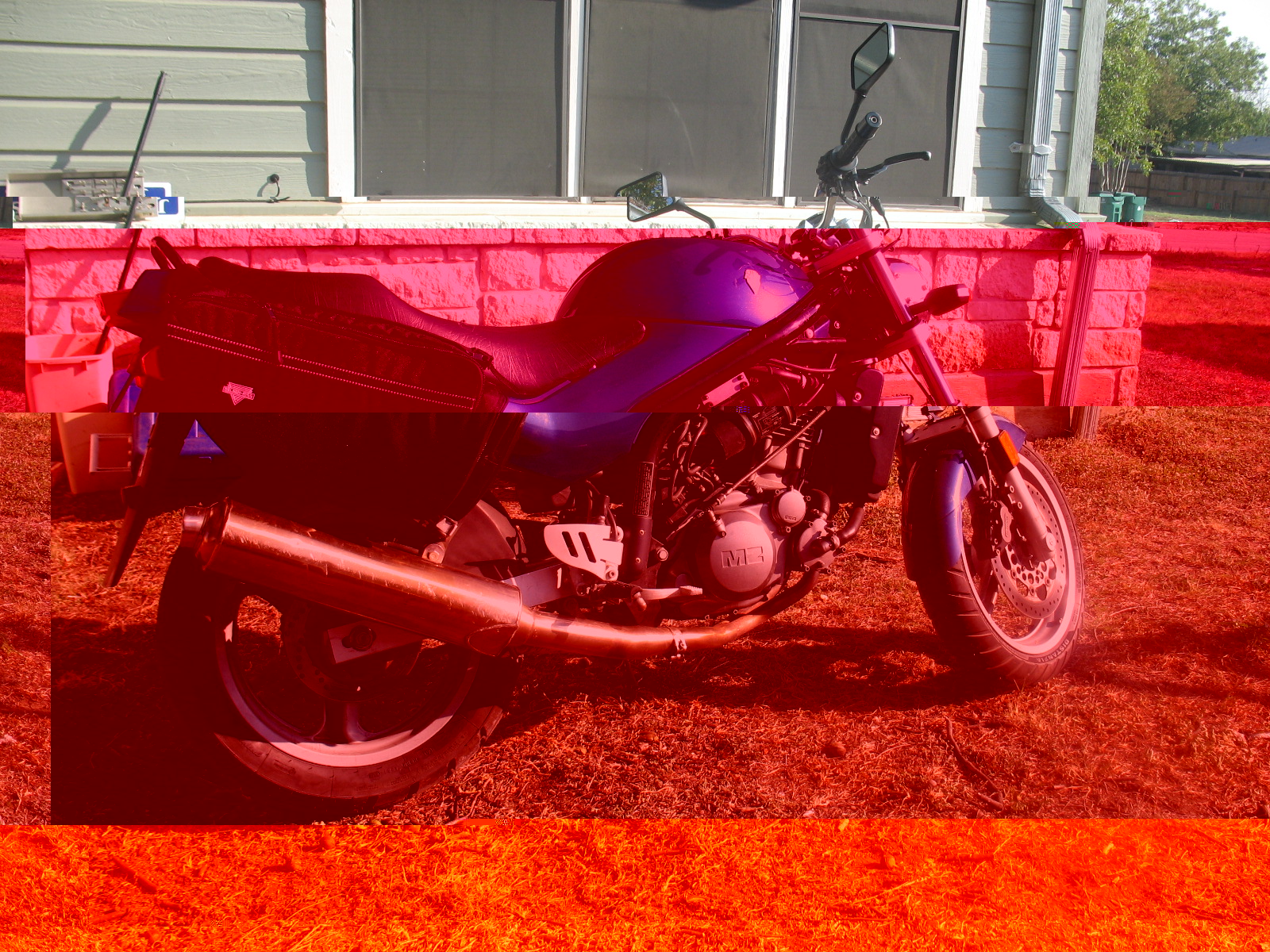

Well here she is for all to see....
2000 MZ Skorpion Tour "Sport Adventurer".....a.k.a. "The Hill Country Rambler" :smt045 :wink: :smt045
So far.....too cool for school! Does great for my commute (60 miles pavement = 50+ mpg), fun on the windy roads, does great on the gravel roads I take to get to the places I want to be...(middle of nowhere) Love it. I wouldn't trade it for a V-Strom, KLR, Versys, or X-Country.... (well maybe the Beemer...)
Front 120/70/17 Distanzia
Rear 150/70/17 Anakee
MZ Skorpion Tour
J-Ball

Postby aah5 » Thu Sep 25, 2008 4:52 pm
Looks good, think about putting a guard screen on the radiator for the the backroads. Made one from expanded steel mesh for mine and it has paid for itself many times over.

Postby J-Ball » Mon Sep 29, 2008 9:21 pm
Hey aah5, that's a good idea I hadn't thought of....just to protect the radiator from flying rocks etc? I have been thinking about a "roll bar" around the radiator, something to mount some forward foot pegs on, maybe some lights or even wind deflectors when the commute gets colder this winter. I think I could make it look like it came from the factory with it if I scratch my chin long enought about it. This bike is lots of fun to ride, I might as well make it work better for me..Right?
Oh.. sorry about the super hugh pics too....
