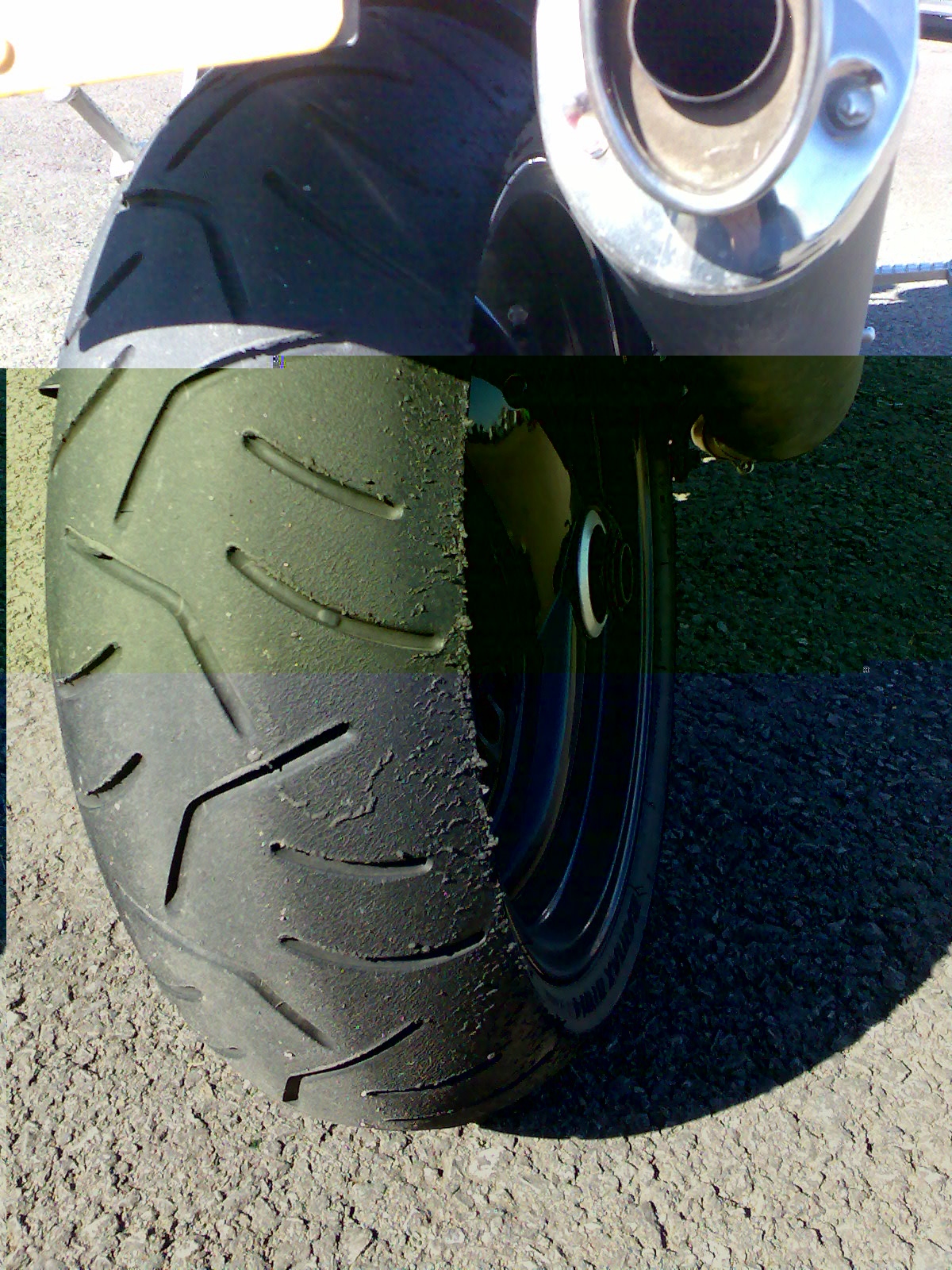

Bill ta for reply like your links done a bit havent you
Bbeen looking into the tyres, I have for the last few years used Battlax,
Will the skorpion have enough horses to warn the tyre up since the tyre is w rated and meant for few more horses kicking some energy into them to warm them.
This is such a different style of riding for me.
As can be seen from tyre below bit too much motorway use (flat bit).

Yes, noticed the photo was not a Skorpion. In street use, nobody gets tires like that with a Skorpion, Besides, the one-arm swing arm is a give away.

Bill
thought you'd notice, thats ma 1999 speed triple - with 955i engine - on stupid day out. Dont do that any more too old!!!! Hence the skorpion for lazy sunday ride outs thro the back roads to Llandovery. To many speed camera now!!!
