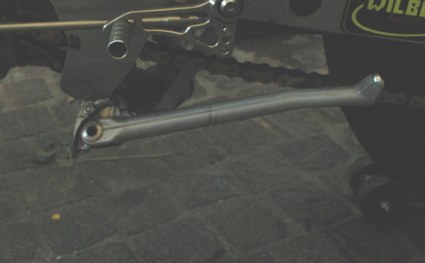

I personally have a slightly modified Ducati sidestand fitted to the Skorpion frame.
not very good pictures
Ducati 2.jpg (62.79 KiB) Viewed 1880 times
ike all Ducati stands, this one snaps up by itself; there is no sidestand switch to cause problems.
