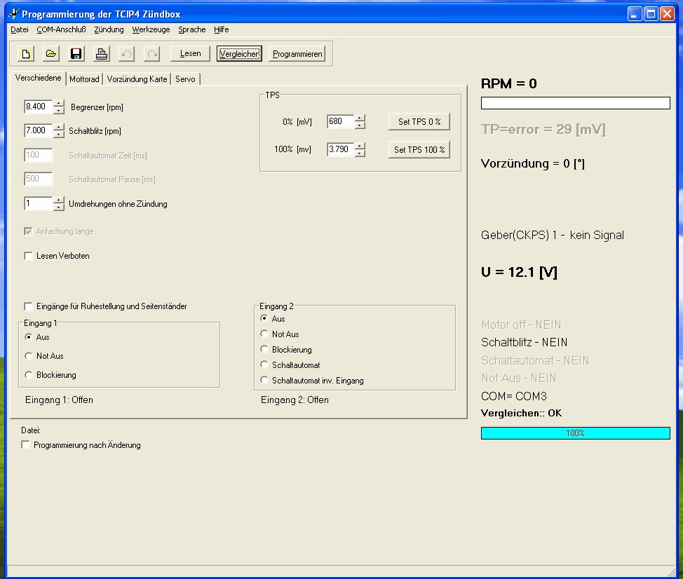

I use only the Ignitech TCIP4 in my 660 engined bikes and also an Ignitech rectifier in the MZ. Their stuff is very good.
I routinely supply it to Skorpion and SZR riders, preprogrammed with the curve I have found to work best with the stock engine.
I also have race bikes running with the TCIP4. And my own engine is anything but stock.
Having sold over 50 Sparkers to various customers all ober Europe, A word of warning, tho. As shipped by Ignitech, the bike will not start with the Sparker.
You must change the setting on the first page of their SW:
turn off the connection for sidestand etc as above.
The supplied curve is not good, either, but you can change that - or write me a mail and I will send you one that does work.
Or buy the TCIP4 from me. I charge 125€ plus postage, so you can see that I do not make a shit load of money off the thing. I normally have at least one on stock.
