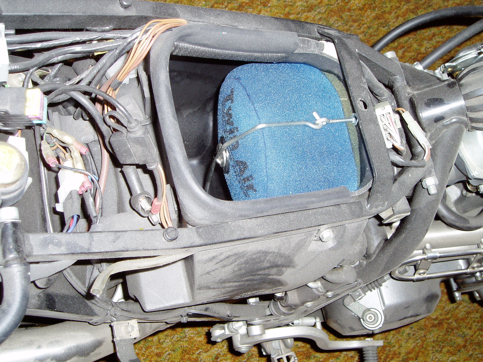

Re: Just got a 2002 Bagharia
Postby OLDMTNCARVER » Tue Jul 05, 2011 10:30 pm
Picture of the filters package.
Scan0001.pdf
Filter package
(721.29 KiB) Downloaded 300 times
Postby OLDMTNCARVER » Tue Jul 05, 2011 10:38 pm
David,
This is the filter that I have in my 2001 Baghira.
Please repost the picture in non-PDF BS and I wouldn't feel so computer illllliterate.
Postby OLDMTNCARVER » Tue Jul 05, 2011 10:41 pm
It fits perfect as the stock filter does...
Postby harold » Wed Jul 06, 2011 5:43 am
I just found the thread with all the specs. It will take a couple of days to read all of this info, so I can figure out what besides the muffler the previous owners have changed. My air filter is a cone shaped foam on a wire frame, and it doesn't seem to fit tight enough to the intake to seal completely. I didn't realize that the carbs are different from a Raptor, so now I need to figure out which one- or both- have the lean jets. Thanks for all of your help, and I will get to reading.
Postby OLDMTNCARVER » Wed Jul 06, 2011 6:10 pm
Harold,
Here's the one that came out of that bag and into the box.
