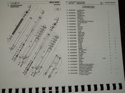

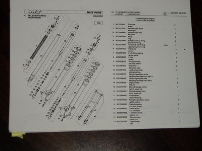

Al,
No experience on the oil weight.
I found the same parts numbers that you posted also by nopantsflyer: (Searching) Interchangable part list, on 5-25-08.
The shop manual is only for the engine...
Here are the pictures provided in the parts list.
Yeah, I know... after the video that you posted I'm a slug... ( slug /snail ), this side of the pond it's all the same... :lol:
Figure the part numbers might help with parts purchase.
