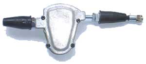

If this doesn't work, it might be worth trying an Easy Clutch. They are used by off road riders to lighten the clutch pull, and fit between your own cable and the boss. Available on US ebay for about $30, or UK ebay at £15ish. Its one of the things that has been suggested for use by the National Association for Bikers with a Disability http://www.nabd.org.uk for riders with reduced power in their hands.
Easy Clutch adaptor
Can't say I've used it my self,but examples I've seen seem well made.
radiograf

Postby den » Sat Aug 25, 2012 3:32 pm
radiograf wrote:If this doesn't work, it might be worth trying an Easy Clutch. They are used by off road riders to lighten the clutch pull, and fit between your own cable and the boss. Available on US ebay for about $30, or UK ebay at £15ish. Its one of the things that has been suggested for use by the National Association for Bikers with a Disability http://www.nabd.org.uk for riders with reduced power in their hands.
I had one of these on my crm250 , fantastic bit of kit ,i cut the lever short on purpose so i could just use one finger to work the clutch.lol.It made holding on for dear life more acceptable,specially with one wheel in the air
