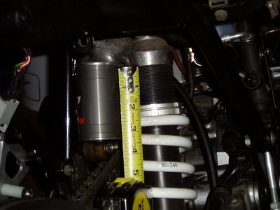

Can any one let me know how much black thread should be showing on the rear shocker above the adjusting nut?

Postby OLDMTNCARVER » Mon Aug 13, 2012 5:29 pm
The picture is of a reduced height Baghira, noting that the forks on this model have no external adjustment as a reference.
Regards,
Robert

Postby den » Tue Aug 14, 2012 5:06 am
i thought that was the preload adjuster,factory set at around a 75kg rider,,Don't think it has to be set at any measured level,just adjust it to suit your own weight and personal preferences.
It could be used to lower the ride height however the bike would bottom out if you ever took a passenger, :oops:
correct me if im wrong,, i just got up,

Postby OLDMTNCARVER » Tue Aug 14, 2012 8:35 am
Just figured the picture of the factory set position as a starting point.

Postby jrm » Fri Aug 17, 2012 2:00 pm
Thanks for the info, mine has been adjusted and I was going to put it back to standard as a a base line.
