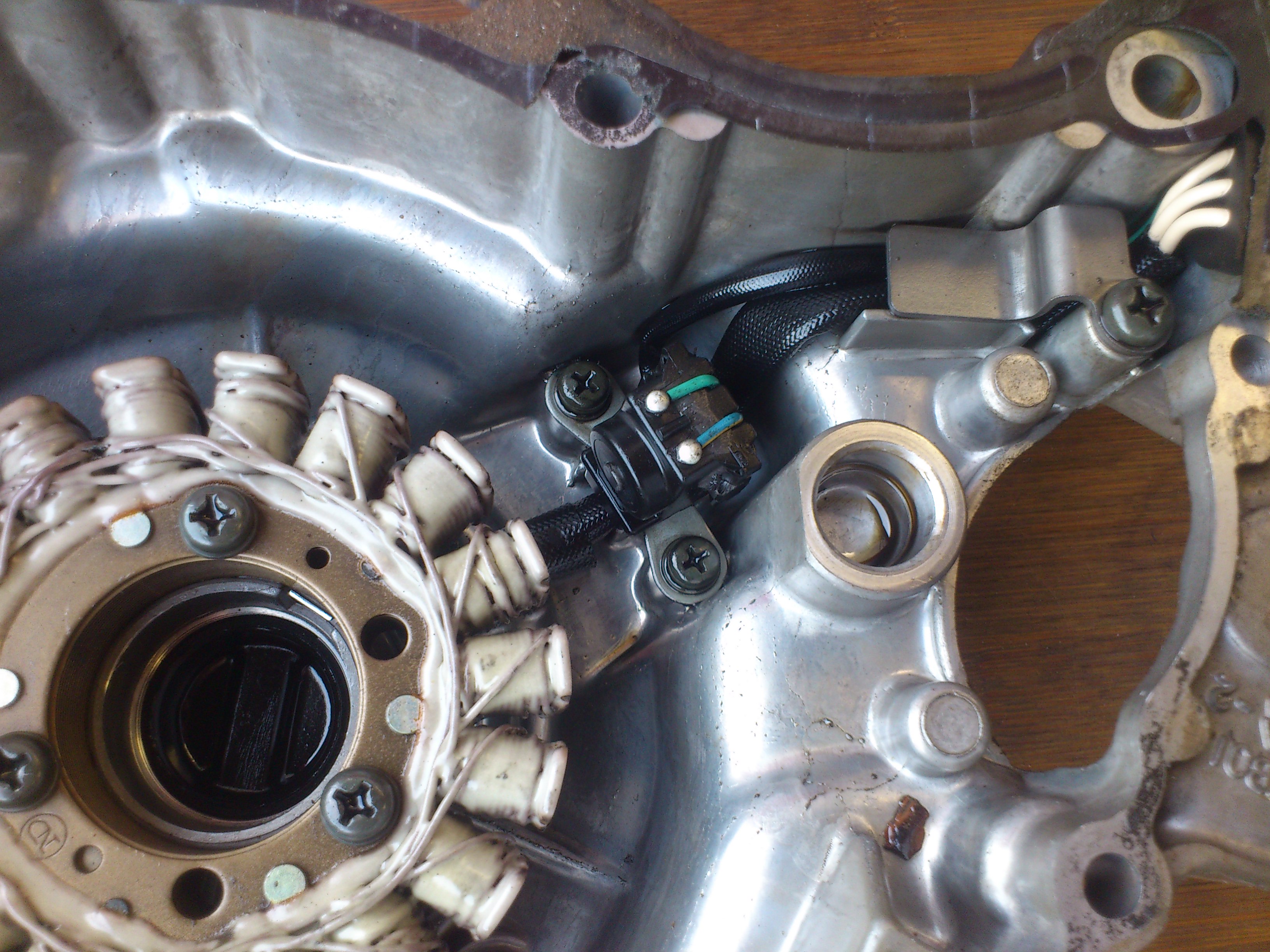

I have the same problem with my baghira... I have no spark. I have 12 volts from the cdi box to the ignition coil, and twelve volts in the spark plug boot, but no spark. I already replaced the ignition coil because there was something wrong with the circuits inside and it showed no resistance whatsoever. The new one is as it should be.
You said something about a crank sensor that is supposed to give signal to the ignition? Where is the crank sensor located? I have the service manual and I can't find anything about it in there. How do I know if it is good or not? Any other ideas? The main switch is good, I have already cut out harnesses and sauldered new connectors on the ignition black box, and on the coil. Check the other connections and fuses? I am at the end of my limited no how, and really like to get this bike going.

Postby Chalks » Fri Jul 12, 2013 3:45 am
The sensor is located behind the alternator casing on the left hand side of the engine:
