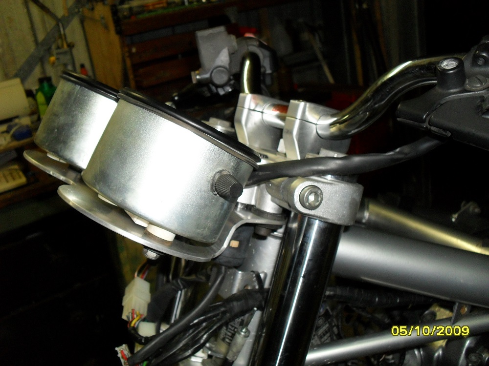

This is the sight that met me when i picked it up a month ago..
The rearshock in need of some new paint
A slow transformation back to some dignity and better shape...
And some new paint...
Cleaning....
Putting it together...
This is the shape it's in for the moment. Month some parts...

Made some progress since i where here. She's running and sounds like a old stone-breaker then idling.. So I'l thougth it could be some problem with the clutch basket or primary drive and as I also own a Ducati, so I*m familiar with ratteling clutches ;) it where my first thought. Anyhow, Some research on the net and off with the clutch cover finding it where little loose. Need to tighten the driveshaft nut and put some loctite on the treads. In a day or two it will be put back together again for a test again.
David.
