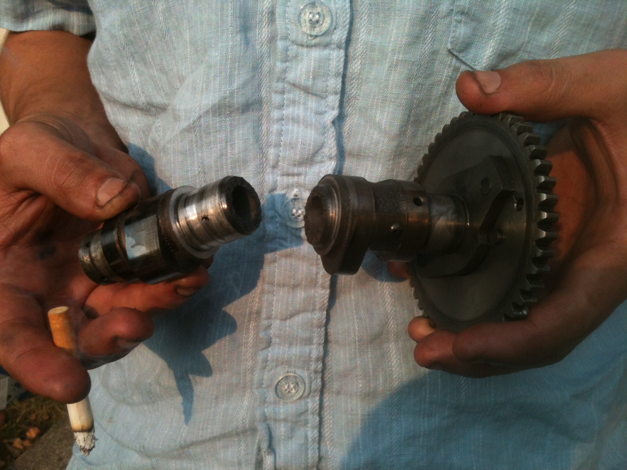

After 30 miles on my first longer trip (excluding rides around the block, in which the bike ran well), i started to lose power. RPM increased but there was no power associated with the increase. The bike then died on me. I got it started again, only to have the same thing happen: loss of power followed by quitting.
I checked spark and fuel. There was spark and fuel, but the spark plug was covered in a greyish oil (looked like water and oil). Compression test showed 0 compression. I should note that i was absent minded enough to not check the spark plug before going on my ride, and when i took out the plug noticed the crush washer was not crushed. So, the PO had not torqued the spark in.
I took apart the top end and what do ya know the camshaft was broken in two pieces (see attached photo). Checking the valves, cylinder, and piston, they all looked fine.
In addition to what i should look out for before installing a new camshaft, does anyone have any ideas how something like this might happen? Any info or advise appreciated.

warped head ?? maybe
some cars are bad about this when they mill the head or block and TQ it back down
with out having an expert head shop do the work
the cam races are bowed
cams are just like people theydo not like there knickers in a TWIST

From the looks of that cam, I seriously doubt your head is worthy of saving. The bearing/bushing area in the center is completely hammered, and the head material is much softer than the camshaft material, so it's got to be toast. I'm surprised you didn't hear the bike screaming for help, or is that what the loss of power was? :wink:

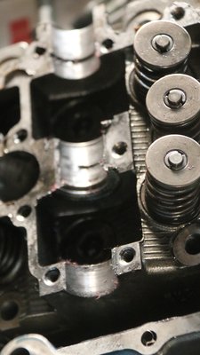

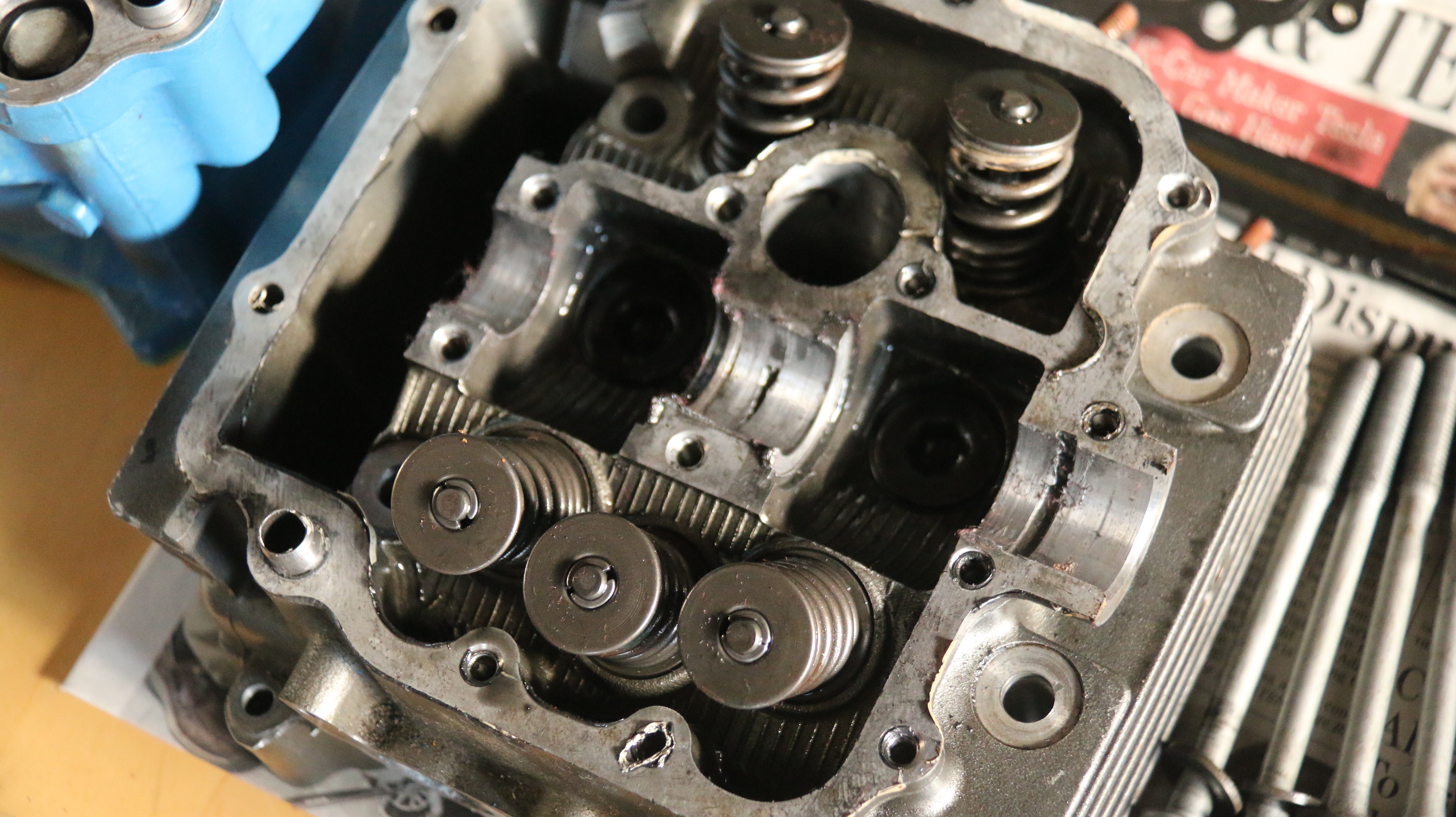

Can you show pictures of the area where the camshaft sits in the head?

by bueller
Thanks for the responses. I've attached a couple more photographs...Don't look promising. And she was such a gem for the first 40 miles...!

Looks to me like you have a paperweight on your hands there. The colors on the camshaft and rocker arms alone tell me the motor has been horribly abused. The condition of the cam bearing surfaces tells me you may need some ear training. That didn't happen without the engine making all sorts of sounds, screaming for help from the rider/mechanic. Hopefully the bottom end doesn't look anything like the top and all of the destruction is contained. Poor bike. :(
