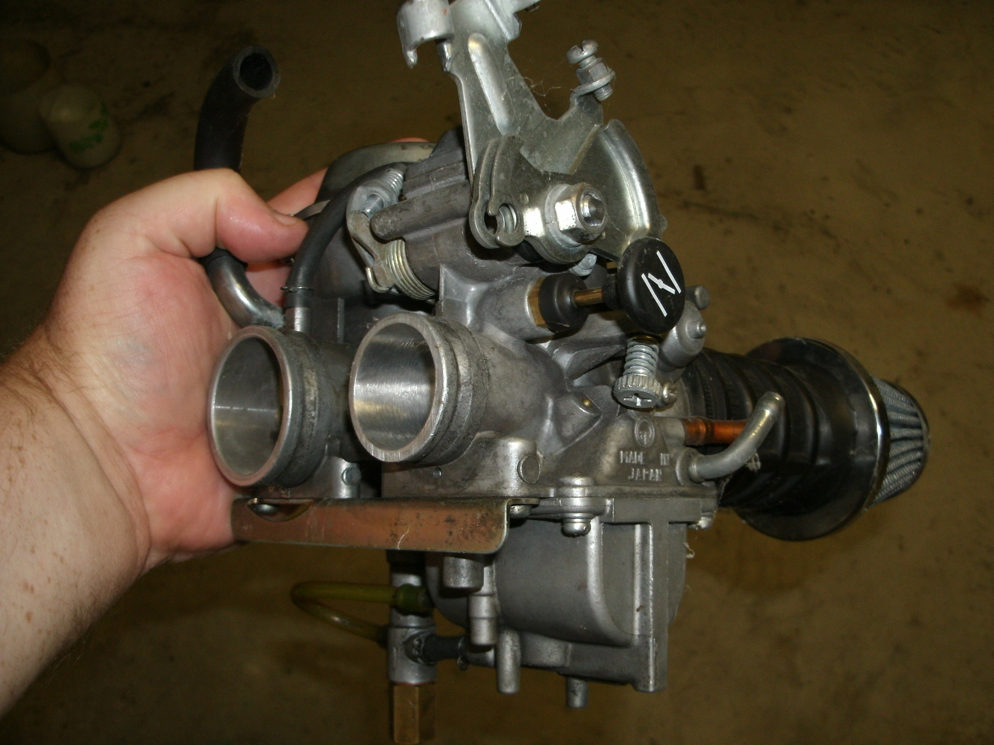

edfmaniac wrote:I recommend ditching the cable and putting a plunger style choke. And yes, if the brass nut is backed off the threads all the way, the choke assembly should pull out fairly easily.

Chuck in Indiana wrote:edfmaniac wrote:I recommend ditching the cable and putting a plunger style choke. And yes, if the brass nut is backed off the threads all the way, the choke assembly should pull out fairly easily.
So, is that plunger choke a Yamaha part?
