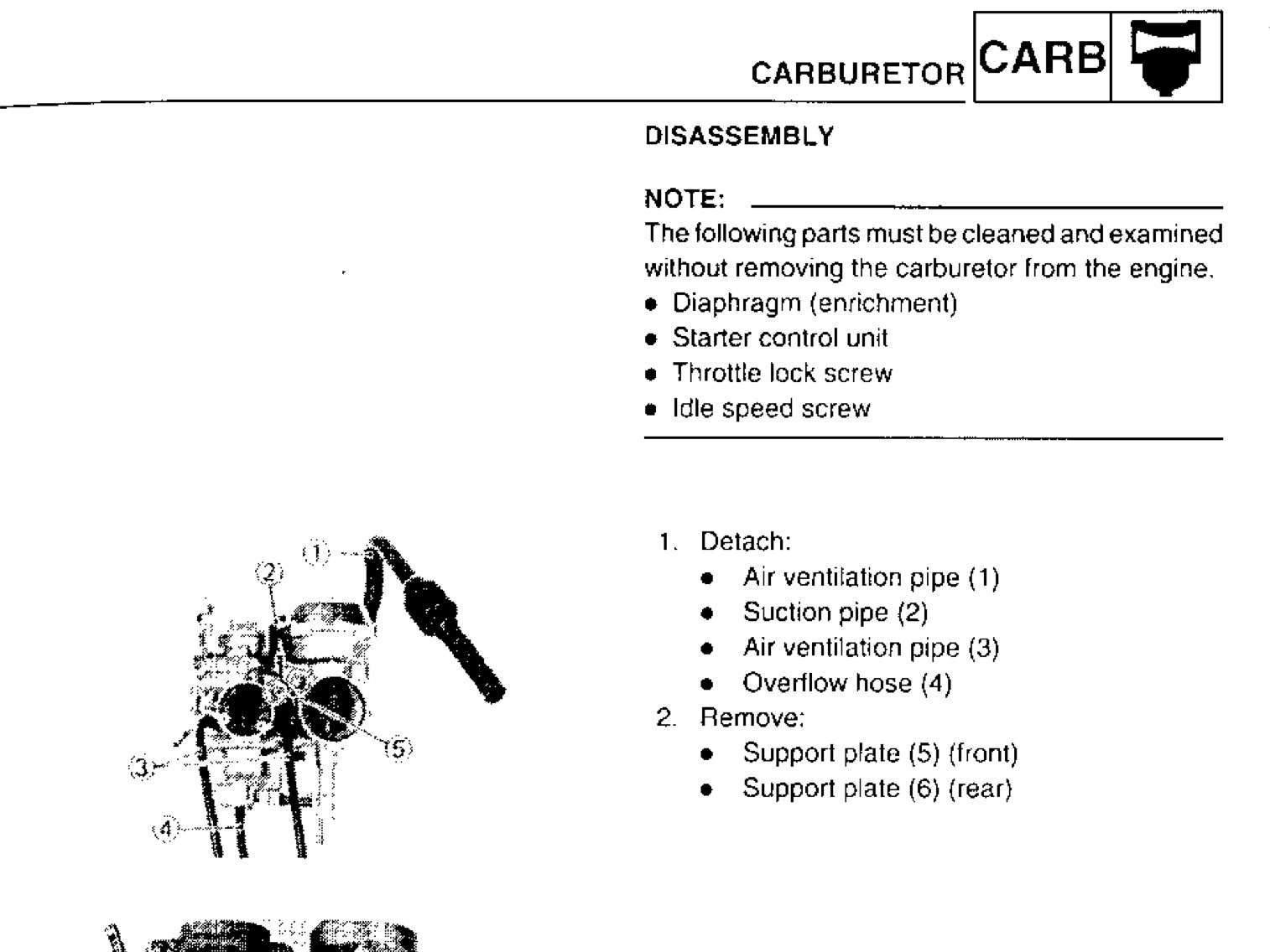

As detailed in a different thread, http://www.mzriders.com/viewtopic.php?f=3&t=8119 I recently took out the carburetor of a 1995 Skorpion Sport, cleaned it, and put it back on the bike. After reconnecting the fuel line, I noticed that fuel was dripping out of the overflow hose ([4] below).

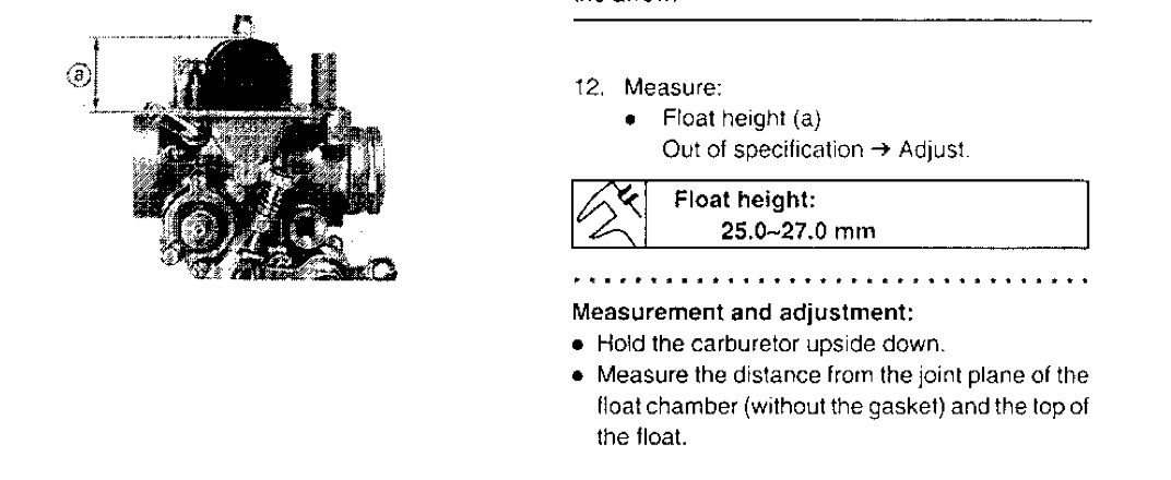

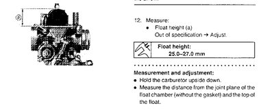

But the dripping would stop when the engine was running. This led me to conclude that the float had been set too low. I thought I had set it right, to 25mm. But the dripping suggests to me that I should increase distance (a), below.
(Of course, I need to double check and see if I had made a measurement mistake last time around...)
Am I right with the diagnosis?
