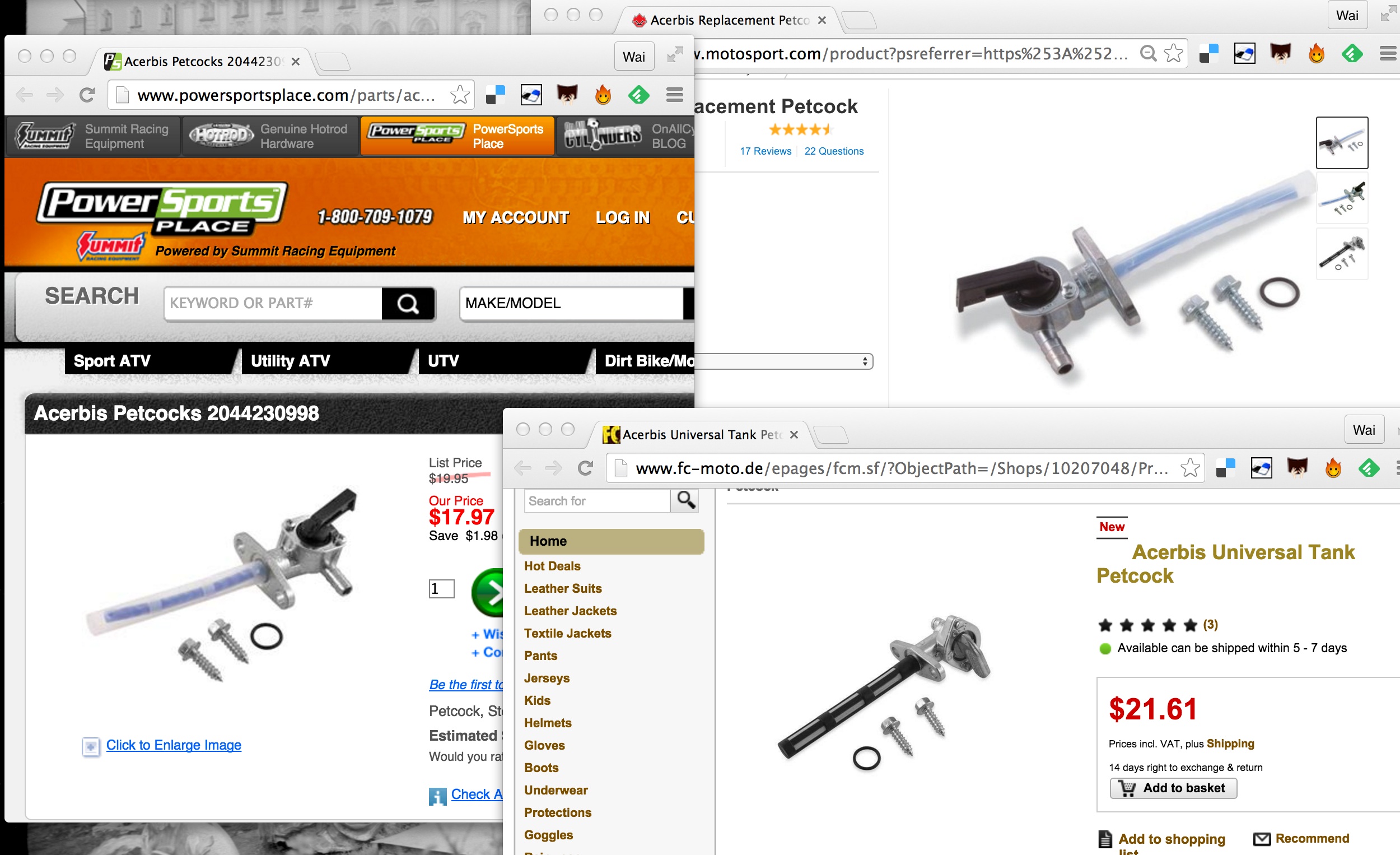

A simple Google search on Acerbis Universal Petcock shows products of slightly different designs. Which one do you use / will work on our Skorpions?
WaiNYC
Posts: 88
Re: 95 Skorp Sport - gas remains in tank after reserve runs
Postby edfmaniac » Fri Oct 23, 2015 4:48 am
Not all images of products for sale show the actual product. The universal petcock has the valve 90 degrees off from the bolt pattern. I see it in two of the photos, the lower right, and as an alternate view in the above right web page. Just order the universal and you should get the correct product.
