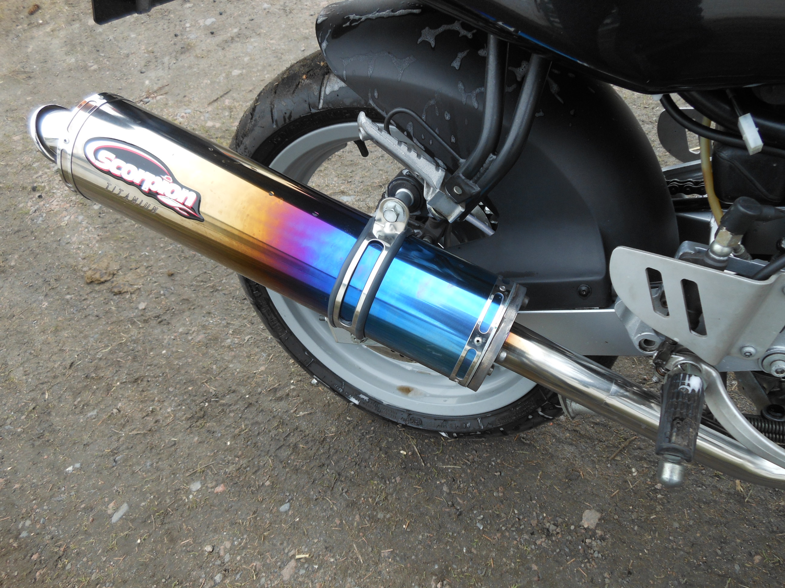

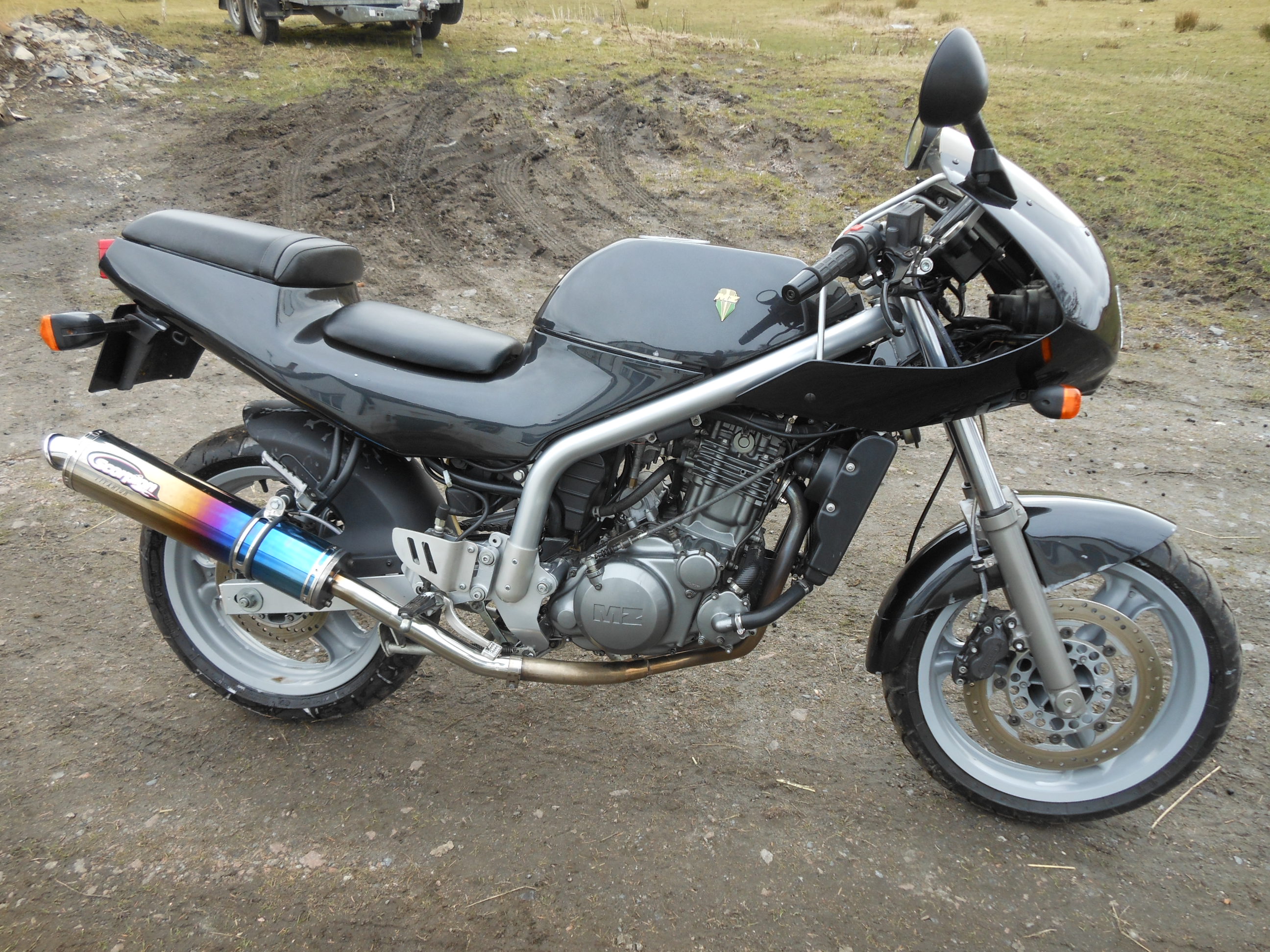

Just recently, I have been getting the Skorp ready for summer and wanted to make it sound more like a big single without being too loud. Fitted this Scorpion titanium end can with a home made link pipe. The flange was laser cut from 10mm stainless, silver soldered inside to the pipe and the link pipe was made to replicate the original length of the exhaust to its outlet.

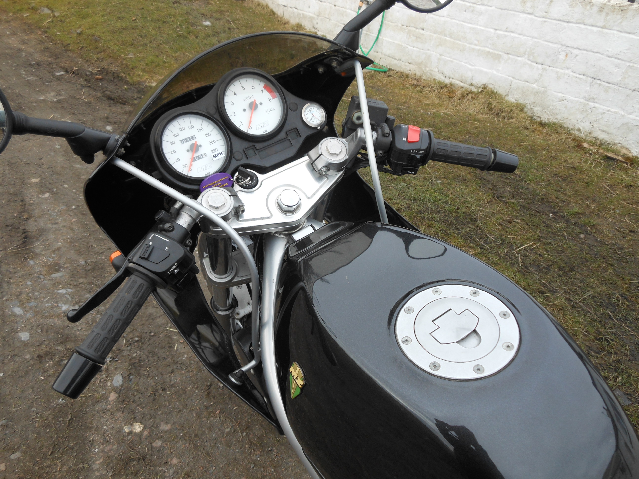

Fitted a pair of VFR750 handlebars which fitted being 41mm diameter , but the choke needed to be resited to the carb using the XT600 unit previously covered on here.

Yes, I have kept all the original parts and nothing has been butchered to do it. Only 2430 Km on the clock, its one of the Japanese imports new in 2011.

Petrolhead wrote:It seems to run better, revving cleaner and idling better, I wound the mixture screw out to 7 turns.......quiet pleased now, all we need is a good spring to ride it a lot :D
Be careful with that. I wound out my mixture screw a couple more turns in order to attempt to cure a low rev "surging" or "jerky power delivery". Anyway, after a short ride to check it out, I couldn't get the bike to start at all without choke. Then, after some more test rides, I discovered (with a mirror) that the slow running mixture screw had fallen right out. :cry:
Must have been my lucky day... I found it hidden underneath the starter. No spring though. I guess that bounced right out, if there ever was one. The bike is running a bit better now and I've fitted some PVC tube over the mixture spigot to catch the screw if it should decide to fall out again.
