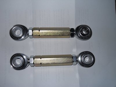

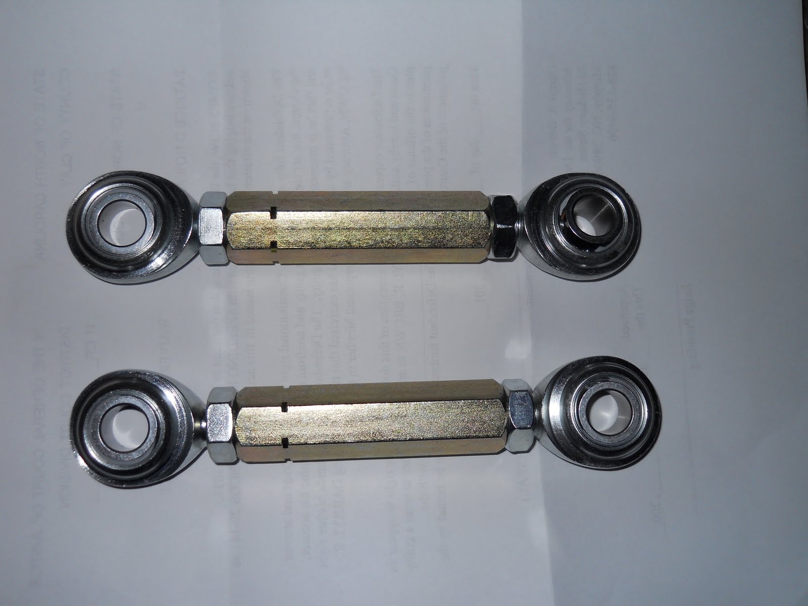

by den
so make some fully adjustable with rose joints,like used in track rod ends
