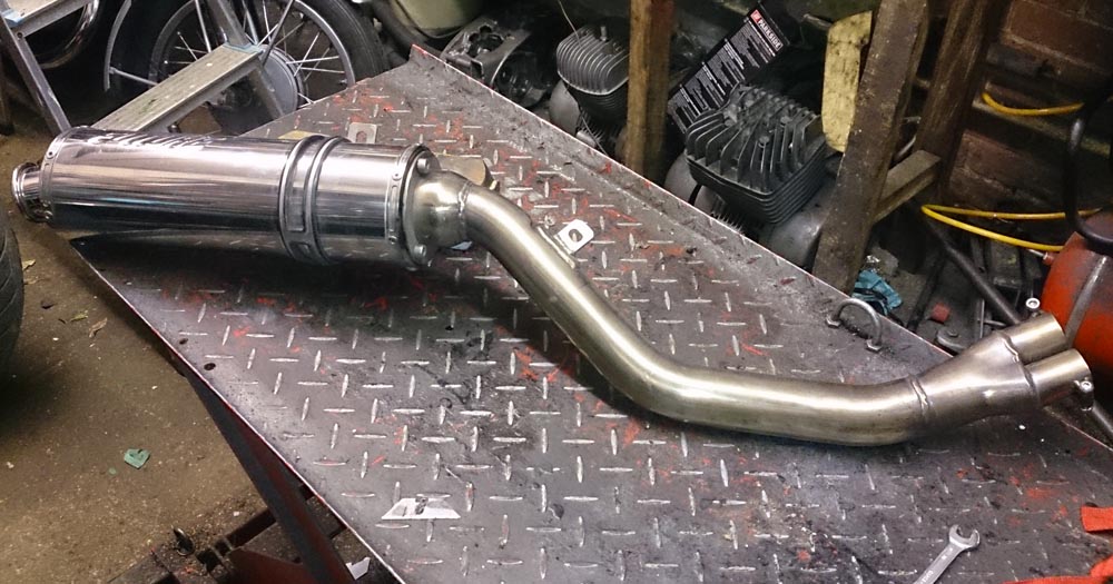

My Baggie came witha Future silencer fitted but it was excessively loud to my ears (my son thought it was awesome) so I fitted the standard silencer which also came with the bike.
However, the standard can is very heavy compared to the Future which looks to be well made. The vendor told me the this can originally had some baffling which made it much quieter but this had been removed and lost. Does anyone have any pictures of what this baffling looked like and where it fitted? The back end seems to be fixed with 3 allen bolts so i presume it can be dismantled - possibly to allow baffles to be fitted.

I have the same after market can on my Mastiff, mine has a mute fitted ( from new) held in with a grub screw tack welded in place at the 6 O-clock position on the tail pipe stub,
Im sure a `Google` search will come up with a suitable mute that can be fitted to reduce the sound.

Peter,
this may help, other sizes available, or an idea for a spot of DIY. :wink:
http://www.ebay.co.uk/itm/Exhaust-silen ... XQCgpRzFDe

Thanks Eric, that's just the information I needed. The outlet does have a threaded nut at the base so clearly the mute was of the type in the eBay ad. Looks to me as though it would need a bend in the mute tube to fit properly though.
I'll have a hunt in the scrap metal bin to see if i can find a suitable piece of tubing.

.A repack with top quality filler and a db killer will tame it,,my carbon exhaust was once a johnson way to big,i chopped it , refilled it, got a db killer and a card kit and its fine, bike chugges along at 70 all day long and tops at 105 mph sweet

got a vampire on mine with removable baffle... very loud with it out.. but pretty tame with it in... i sold my future to someone on here a while back...
