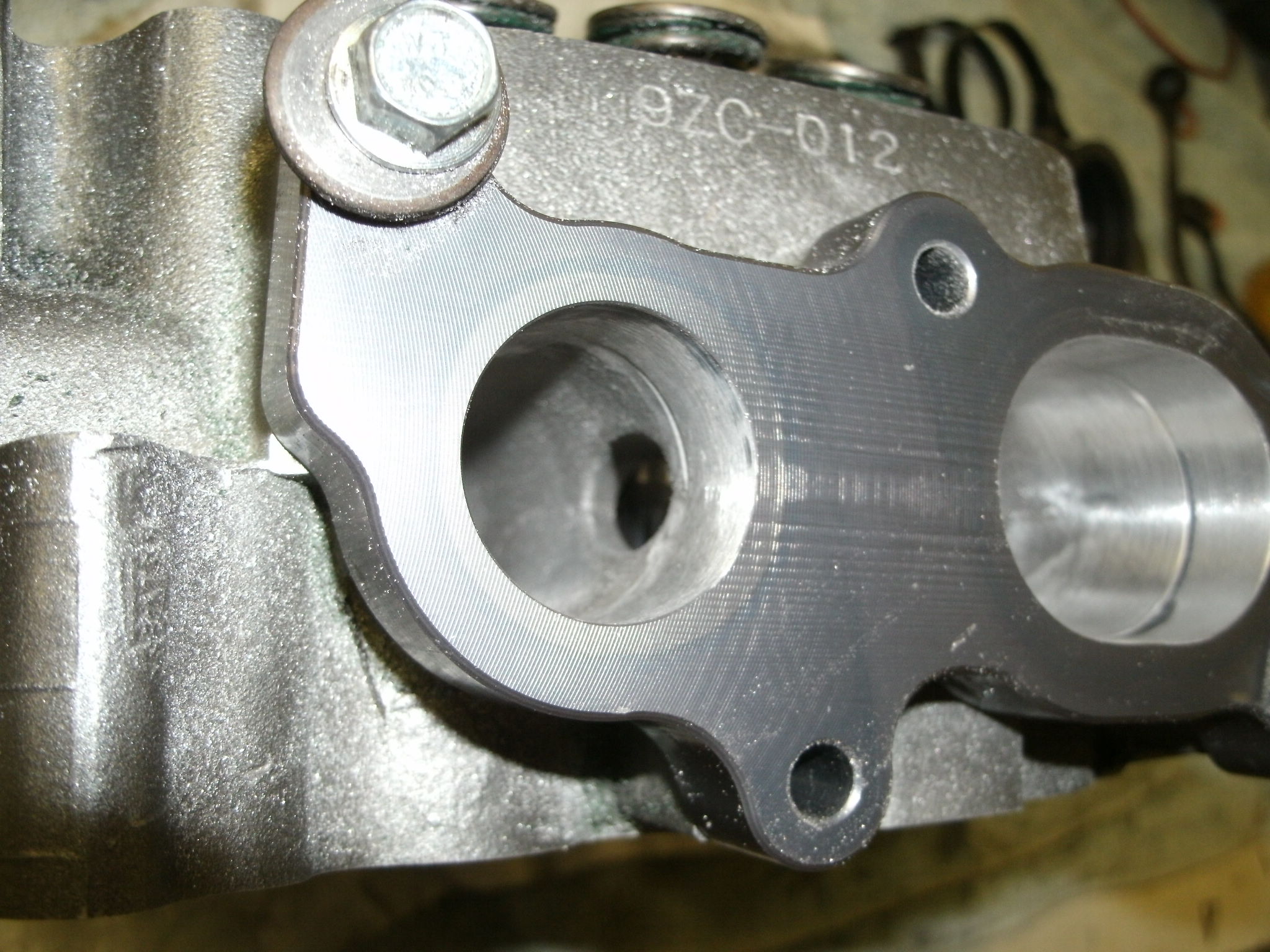

Full exhaust or just mid pipe and/or silencer? If the stock headers are in place, and they are anything like the stock Skorpion headers, you'll need to grind the welds on the inside for the aftermarket exhaust to do it's job. They are very thick on a lot of factory exhausts. You can open them up at least 2-4mm usually, which is a lot if you run the numbers. On the intake side, it's usually the snorkle that is the most restrictive element. Pull that thing out, get a good air filter, grind those welds, then rejet the bike and you'll be pulling wheelies with much more ease than before. There was also a kit developed by, I think it was a company called Tunebike, that made the engine respond much more quickly and flow more volume of air. A company called off-the-road in Europe used to sell them but I can't find them anymore. If you do find one, don't use the drill bits in the kit to modify your main jets, they are much too large. Just do the mods on the CV slide and diaphragm and start leaning the bike out. The stock main jets are stupid rich, and the pilot jet too lean on the Skorpion. Don't know if they treated the Baghira carbs any different but I doubt it. That's all cheap horsepower. If you really want to clean up the intake, buy an intake spacer for a Raptor 660 and use it as a guide to port match your carb boots to the head. If the added thickness makes it too hard to get the carbs back in, you can always pull it back out. But the boots will be matched now and flow much better. Then again, it would be hard to keep those aluminum shavings out of the engine if doing this while assembled.
