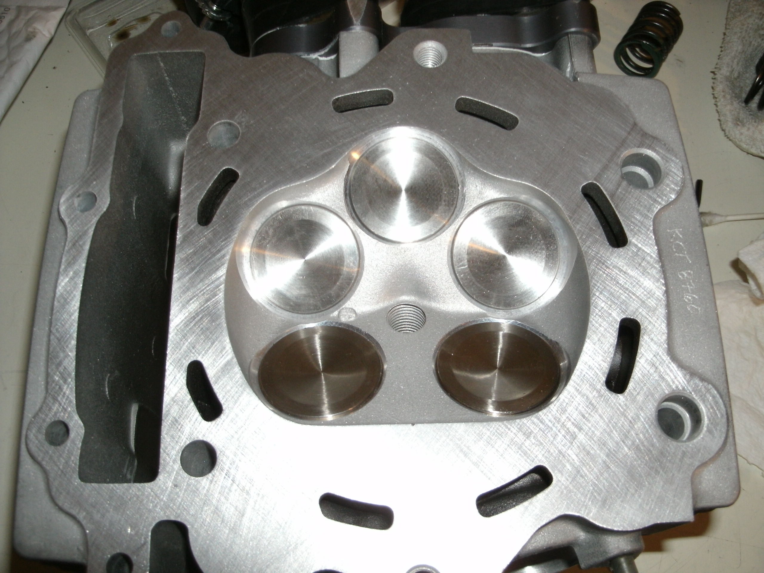

Be VERY, VERY careful when fitting a high lift cam that the spring retainer doesn't tangle with the stock valve guides. I'm building an engine with 12:1, 727cc CP barrel/piston kit and Hotcams 3 - it's essential to fit Kibblewhite or similar shorter valve guides, or at least remove 1mm from the stock centre guide. I have K'white black diamond valves and springs to match. The valves have deep recesses to lower the comp. ratio to 10.7:1. I'm also using a Carillo rod.

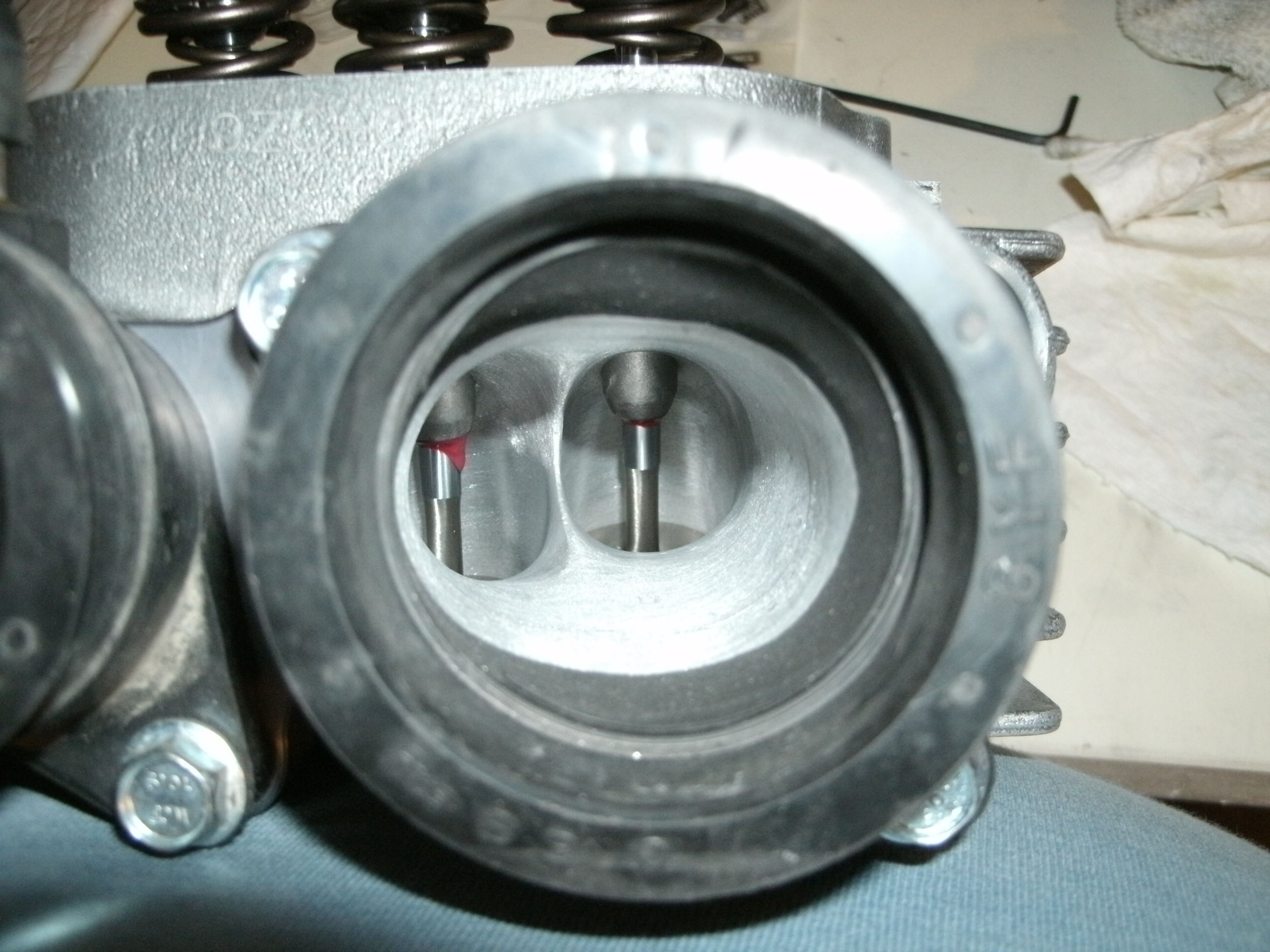

by edfmaniac
dandywarhol wrote:Be VERY, VERY careful when fitting a high lift cam that the spring retainer doesn't tangle with the stock valve guides. I'm building an engine with 12:1, 727cc CP barrel/piston kit and Hotcams 3 - it's essential to fit Kibblewhite or similar shorter valve guides, or at least remove 1mm from the stock centre guide. I have K'white black diamond valves and springs to match. The valves have deep recesses to lower the comp. ratio to 10.7:1. I'm also using a Carillo rod.
I just sent my head to a pro and let them handle the modifications since it needed a valve job anyway. I can measure clearances and bolt stuff together but am a little short on machining skills/tools.
