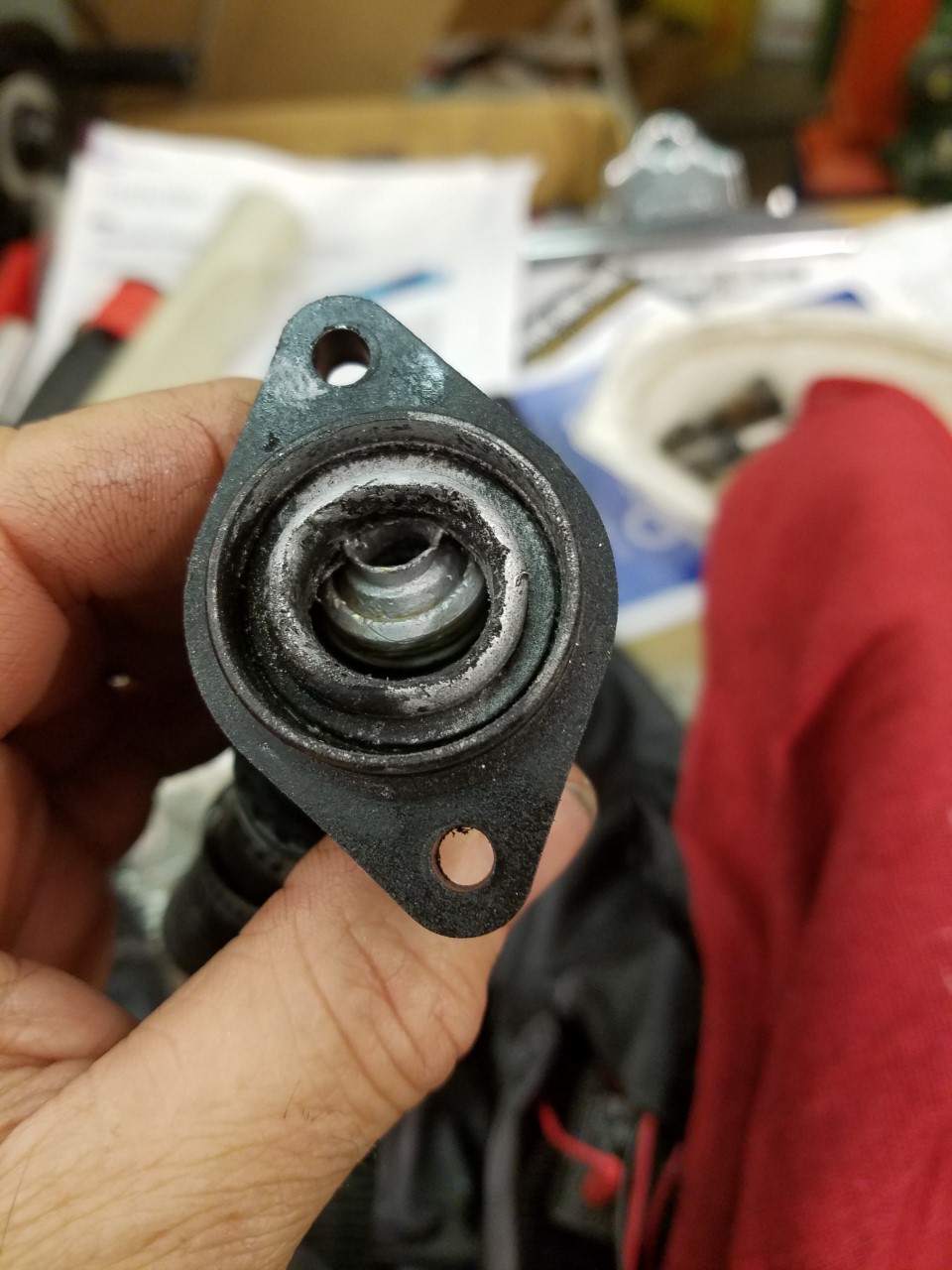

So I took the thermostat apart and this is what I see. Cocked valve from get go or cocked on purpose cause of over heating? Are they available ? cost? Any aftermarket ones I can get locally at motorcycle shop or auto parts store? thanks

Gee, and after I told you that I have never had a thermostat problem!
I think I have one if you are in a HURRY. All you have to do is send me another to replace it.
Will message you my cell. ---Steve

thanks Steve, lets hold off on it for now. Bigger fish to fry. I gutted the thermostat since it was ruined anyway and will just do without till I can get the head gasket to stop blowing. I just put it all back together and tried running it this morning, which it did till I noticed oil coming from between the head and cylinder.
