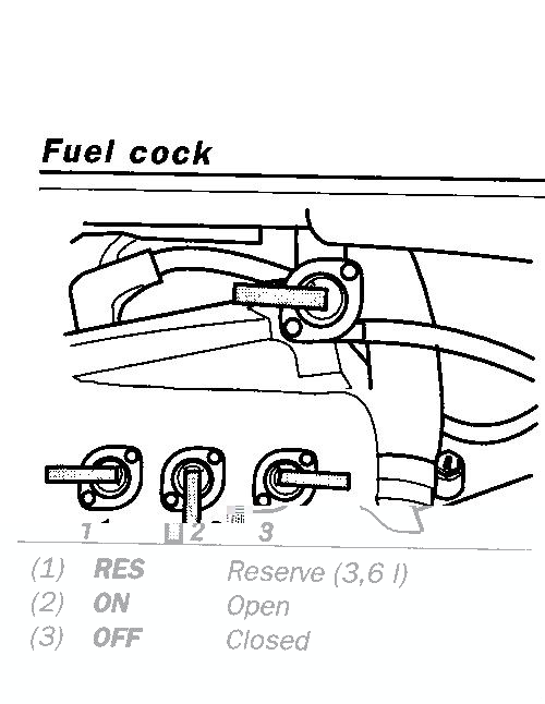

The problem I have, is which position should the petrol tap be in when it's off. There is a switch that can either be pointing downwards, or pointing to the left or right. On the left side of the tap it says "off", however the engine still runs when the tap is pointing in that direction. I'm confused, as I'm not sure whether the bottom of the tap should point to Off, or the top of the tap.
Has anyone got any ideas, please?

LEFT CLICK ON PICTURE BELOW TO GET A FULL VIEW
rt125 fuel tap positons
rt125 fuel tap positions edited.jpg (48.54 KiB) Viewed 3060 times

I had the same thing happen to me (posted the problem on this site about 2 years ago). If you look at the petcock, there is a small black arrow on the black plastic petcock, that points to the mode the petcock is turned to (ON, OFF, RES).
