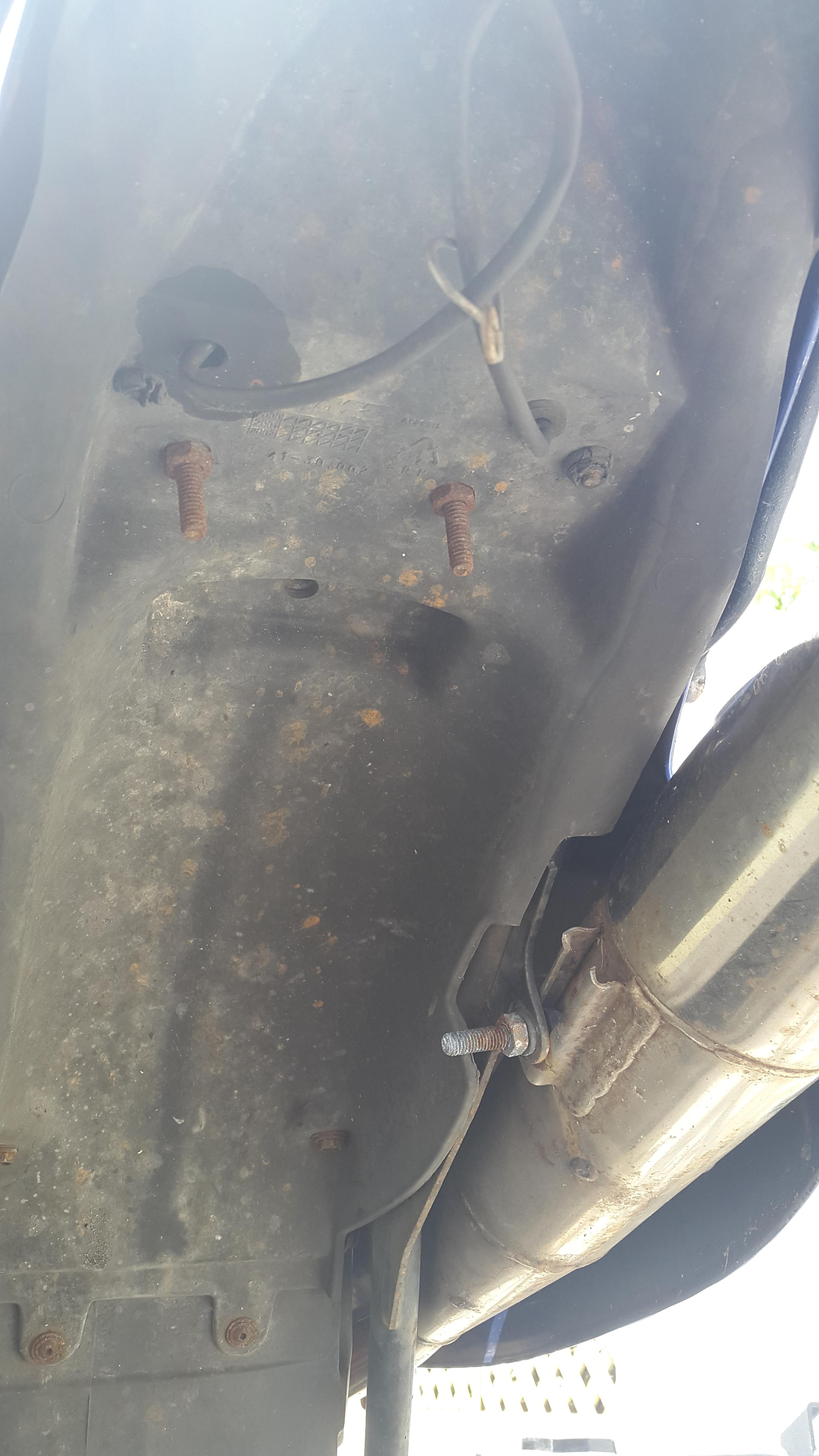

Postby kdesilva » Wed Jul 22, 2015 12:50 pm
Here it is. Thanks to the pic I've actually had a better look at it .. do you reckon it's the hole sort of between those two long bolts?
\EDITED to post proper size picture

Postby DAVID THOMPSON » Wed Jul 22, 2015 2:30 pm
this not what the parts book shows
me thinks this bike suffers from several past owners
those two rusted bolts need replaced with an oem bolt
or SS bolts i think "JIM JOB" has been hard at work
hope he did not work on the electric system
need to fix this ...as those rusted bolts will be hell to get off if they rust some more

Postby kdesilva » Wed Jul 22, 2015 2:44 pm
Which ones? You think those two rusty ones are holding down the seat? I think they are actually for the rack on the back...but I will take another look

Postby DAVID THOMPSON » Wed Jul 22, 2015 2:59 pm
the 2 rusty ones
there too long to be oem parts
if you need to work on some thing
this needs corrected so you do not have a mess
getting to what the real problem is
i do not think the 2 rusty ones are for the rack
but they may be holding on the seat as well
if the original grab rails have been replaced
and the country your listed from explains the rusted bolts
its hard to get away from the salt when you live on an island

Postby kdesilva » Thu Jul 23, 2015 4:59 pm
I can confirm those two rusty bolts were not holding the seat down... I pulled them out and she's still stuck on lol.
There's something central that's holding it, when I lift up the back end I can feel it being held right at the center

Postby DAVID THOMPSON » Thu Jul 23, 2015 8:44 pm
maybe past past owner knows how its on there
or look up that center hole and see whats in it maybe an 4mm allen hex screw ??
or see if the fender liner will come off with all the screws removed and then you can see the problem

Postby stephendacosta » Thu Jul 30, 2015 6:54 pm
There is supposed to be one Dzus fastener to retain the seat from middle of under fender. If the fastener is gone and no bolt is present, slide the seat rearwards. It is held by both forward and rear plastic eyelets. You might need to push down while sliding it rearwards.--Steve
