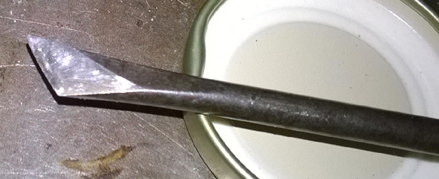

As for the project progression. Yes I did sand a little of around the burrs, but so little removed I forsee it as a non-issue.

On the sanding, it's no issue in the sense of consequences, I just would have preferred to use a knife like this:
Insofar as consequences are concerned, I suppose you could also just have left it.

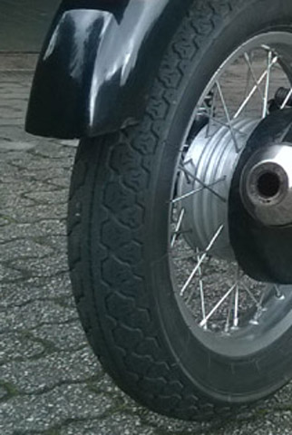

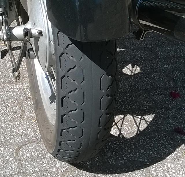

Anyway, at a bit of a loss of things to do, but a sudden apparentness of having time on my hands. I decided to change the tyres, which I must admit was something I was going to do quite late in the process.. But I ended up doing it now.
The rear on this is a Vee Rubber VRM-159 3.5x16 that cost £33 and the front is a Kings KT-918 3x16 at a cost of £19
I managed to re-use the tape of both wheels, and although the front tube had a bit of a leaky valve, I lubricated and ran the core in and out a few times and it's now sealed. The rear tube had a patch near the valve which is no longer sealing. So although I bought a brand new tube, I put in an old (and patched) tube that I had sitting around that was on the rear of my etz251. I'll repair this Pneumant tube (both pneumants and in seemingly great condition), and put it aside for the future.
As for the looks of them. The front looks okay. I'm not sure I like the look of the rear too much.. The tread makes it look a bit like some pneumants/heidenaus or metzellers, but the way it goes around onto the sidewall I think looks odd. But still, they'll do well I am sure! :)

On the tyres, from what I see that Vee-rubber seems to look fine. And if the steel belt in the bead breaks, the old one was bloody dangerous!

There's nothing wrong with the tyre. It just looks funny to me.. I'll get used to it.. Also it's new, and all new tyres do have a nice colour to them... when they fade through use and get dirty.. It should look better.. 8)

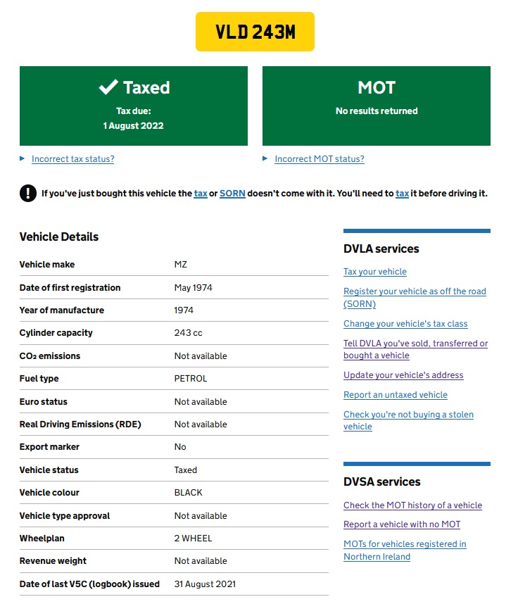

EDIT: I often look up the DVLA website to check whether my papers have been processed. And after 7 weeks, they finally have..
And from that, I can see that they have confirmed also that it is now registered as 'historic', as the bike is now 'taxed', and the MOT (road safety yearly inspection) is green, meaning it's MOT exemption has also been confirmed. Shouldn't be more than a week now until I have returned paperwork and I can see if they spelt my name wrongly or something like that which requires sending it off again... :roll: :lol: :lol:

On the way the thread goes around onto the sidewall: yes, on this VRM-159 indeed the outside edge is open, while for instance on the Heidenau K36 & Metzeler ME77 the outer edge is closed:

A closed edge might be preferable for stability at high lean angles, but I think any benefit is small, and many tyres in this class have an open edge (various Mitas, even the M45).
Congratulations on your administrative progress!

RE Documents: Indeed I was correct in my last post. I have received my documentation. Spelling and vehicle classification is correct. Basically, all I need to do is put the bike together and insure it and I can ride it legally. I'll definately have to do A LOT of local test riding when that day comes... :lol:
As for open/closed edged tyres, I doubt these bikes go fast... I mean... I don't go more than 70 really through being nice to the bike/engines. I think 60/65 might be a nice sustainable speed for this machine.. (?) Anyway, can't tell until I ride it, and even then- I doubt i'd be doing that speed on the edge of the tyre.. 8) 8)
