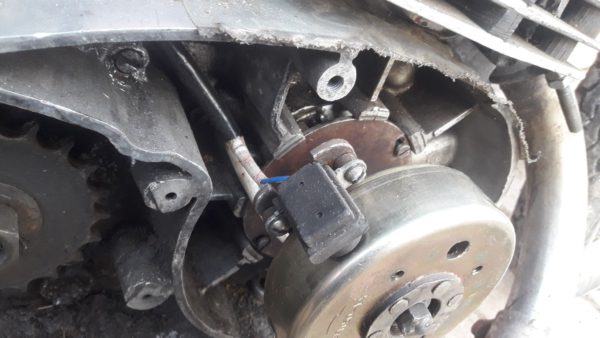

Just for reference, so you can see exactly what I mean
Turbo zabytki version, with an adapter:
And audiobas with one solid piece:

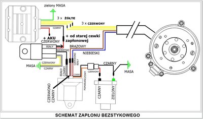

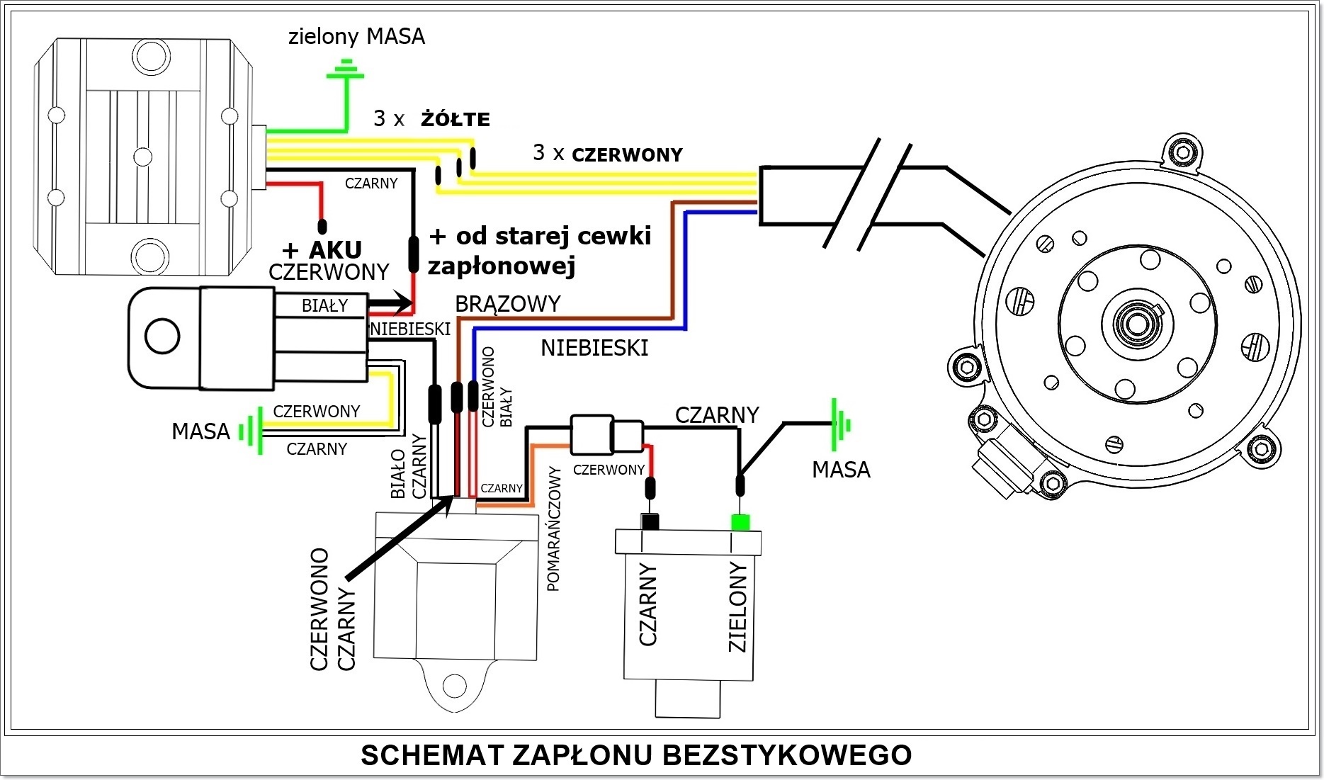

Puffs - you are right! I just mailed and checked, as it's based on GY6 I assumed 150W.
If there's any doubt in their reply I'll cancel and go with AudioBas. I've attached the wiring diagram for the torbozabytki in case anyone is interested

On specification, I see Audiobas does specify the voltage. And a few horror stories...
Is that rotor supposed to be so far to the outside?
