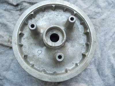

Re: Not so common ETS 250
PostPosted: Sun Aug 29, 2021 1:51 pm
by Guesi
dirtsurfer wrote:incremental progress: I have respoked the rear wheel. I am currently waiting on new streering head bearings to arrive
Are you sure this is the right brake drum ?
For me it looks like one from TS/ES 150 bikes.
The ETS 250 drum should look like this:
I see what you mean. I will have to investigate further. I hope that wheel fits, The spokes weren't cheap.

by Guesi
The wheel you have should has a diameter of 150 mm in the brake side.
The original wheel has 160 mm diameter.
Can you send a picture of the brake shoes you have for this wheel ?
