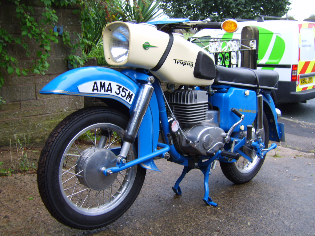

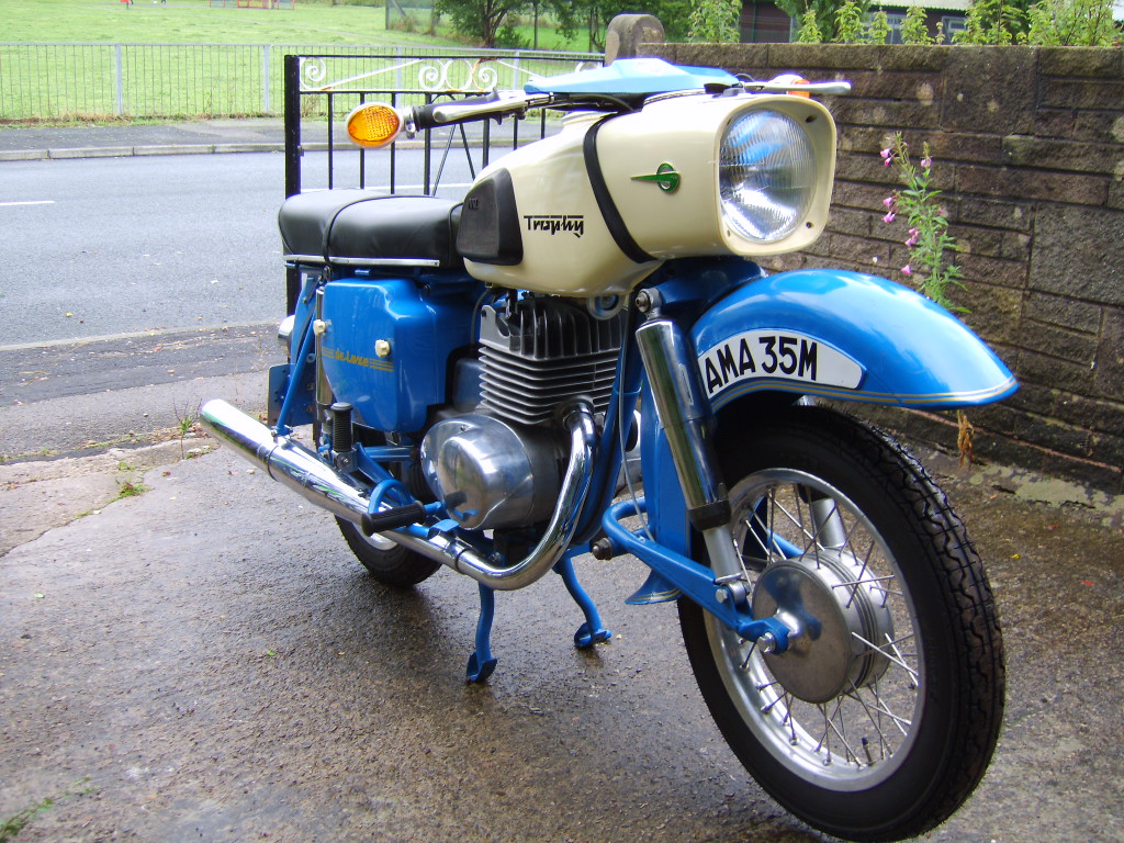

Hi all,
if anyones interested, here's how it turned out, I'm now running her in, and will, in due course, be asking a few questions, but for now:-
Sorry, don't know why my top two pics are cropped, just imagine the rest.

Postby DAVID THOMPSON » Sun Dec 04, 2011 5:32 pm
outrageously NICE JOB is all i can say
if your day job goes away consider being a bike restorer
Dave
and do lock it up so some one don't NICK it on you

:shock: WELL DONE! WOW!
When i saw the first pic - the unrestored state - i was going to say "Good for you" for saving it. Then i saw the pics of it restored. :shock: oh my goodness, i wish i was there so i could try to buy it from you. :)

Postby DAVID THOMPSON » Tue Dec 06, 2011 6:59 pm
this is too nice not to show full screen saver quality pictures
its a bit strange looking but nice
CLICK ON PICTURE 2 TIMES FOR A BIG VIEW site crops picture size
