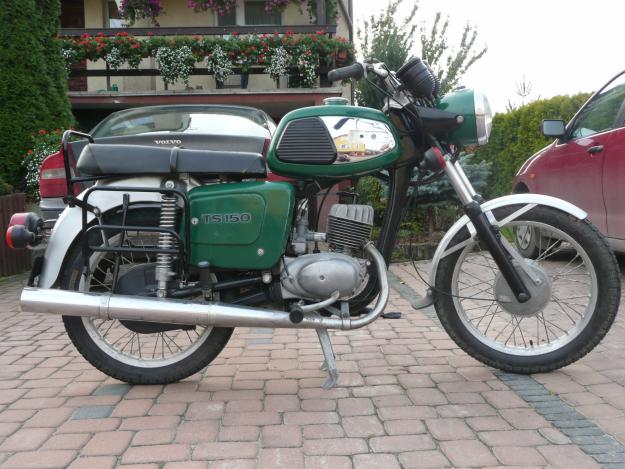

heres a couple of pics i did the one in bnw for nostalgic purposes
Re: maiden voyage
PostPosted: Mon Apr 09, 2012 9:58 pm
by ghostinthemist
the one thing i love about every MZ pic i have on my comp is that there is a secondary picture provided by the shinny side panel in every picture that shows Germany and England in the background. This one is I think a very stereotypical American reflection.

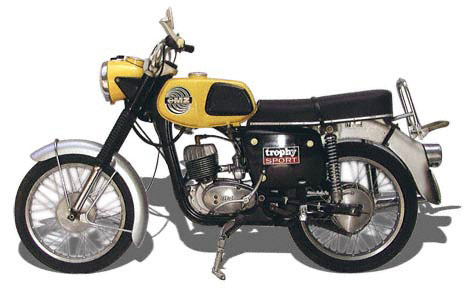

Don't like to contradict you........BUT....... the forks are the early forks as fitted to the ETS between 1969 and 1973. These have chromed steel bottoms and are just about impossible to take apart unless you have the proper tool, and even then it can be a total pain!
Here is a picture of an ETS 150
Then there came your TS150. If memory serves the tank, rear aluminium part of frame and seat are different to the ETS

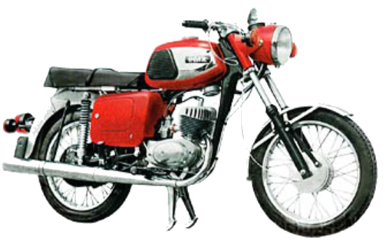

Then comes an intermediate. This has the later forks with aluminium sliders , which necessitates a different front mudguard and brake plate.Also has a different mounting for the rear light

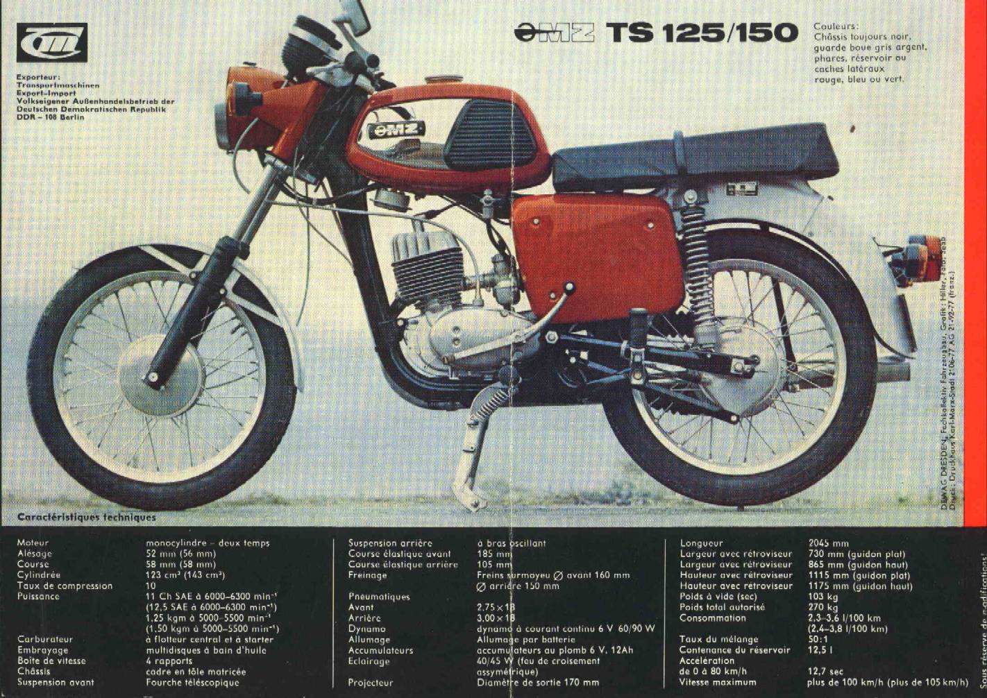

And finally the last incarnation of the TS150. Later forks, different headlamp, and rev counter and speedo on aluminium dog ear brackets
So there you go, a quick history of the evolution of the TS150!

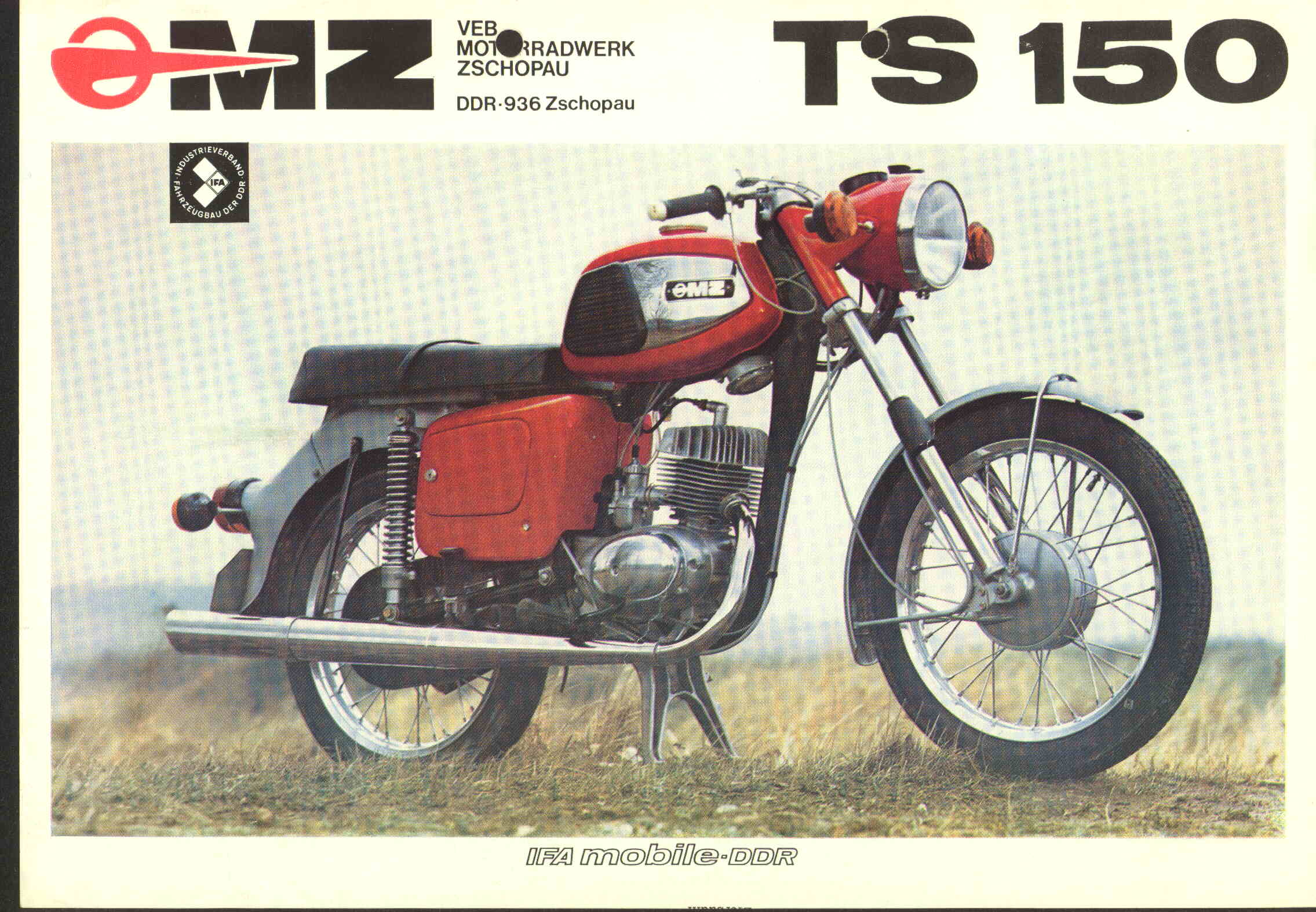

No need to be confused! You have an American version 1974 TS150. However apart from the tank and seat the bike was the same as the ETS150.
However by 1977 the front end, instruments, headlight and rear light had been changed. However MZ never changed the model name!
