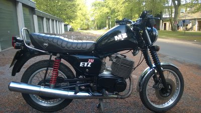

Postby Diligaffer » Sun Jun 01, 2014 9:39 am
I posted this thread on 'Mechanical talk' too. My recently bought 251 revs uncontrollably past 6K. Bike starts easily - often after first kick but as soon as I disengage the choke revs go out of control.
Tried to change the carb settings when bike is running but it doesn't do anything at all (I just got a brand new carb - original BING 84 from Ost2rad.de, new intake hose, air filter appears to be fine and battery is fully charged).
Engaging choke around halfway makes rev go down and then she idles around 1K or slightly below that and ticks over nicely. I tried opening the throttle to see what happens but it just makes induction noise for few moments and revs very very slowly climb up.
Spark plug colour is black - so it runs rich...no surprise here thou as it was running on choke. I just don't want it to keep running around 6k as it sounds like its gonna disintegrate.
Any ideas what might be the problem?
