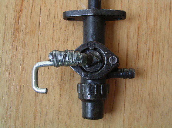

Last april, at last I bought me a Skorpion Traveller.
Somewere on the web I had read that the fuel cock could be a bit tricky to reach. And on my Traveller it was almost impossible to turn unless I used both hands.
I had to buy a new fule cock. But still it was a bit hard to turn, particularily when it was time to turn it to the reserve.
I had to make som kind of lever.
A "hook" glued with Araldite and reinforced with wire.
One finger is enough.

I don't shut mine off - I don't even have a petcock installed. I habitually remove them, replacing them with a quick-release hose connector. In the case of the Skorpion, the petcock is notoriously too small, another reason to do away with it. The quickrelease makes removing the tank easier in any event and on any bike. On the Skorpion in particular, where the petcock catches on the wiring harness and has to be carefully forced thru every time. And the quick-release can of course do double duty as a shut-off where it it is necessary; you can't be better shut off than entirely disconnected.
