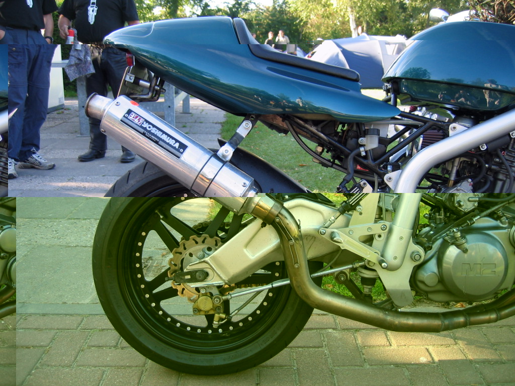

here is a nice special I saw at the Dutch meeting.
You can see some of his one-off space frame of small diameter tubes.
Lots of other goodies on this one as well, especially the Astralite wheels!!

What swingarm would that be?

SZR660 Swinger, and adjusters I reckon.
I've got one for sale.

i'd like to have a aluminium subframe too, the original one is pretty heavy. but welding alu it is the problem :|
@ Bill: that skorpion has a lot of goodies indeed, do you perhaps know what the axle is between the rear caliper and the frame?
that bike looks great altough i dont like the space between the tank and the rear panels :wink:
