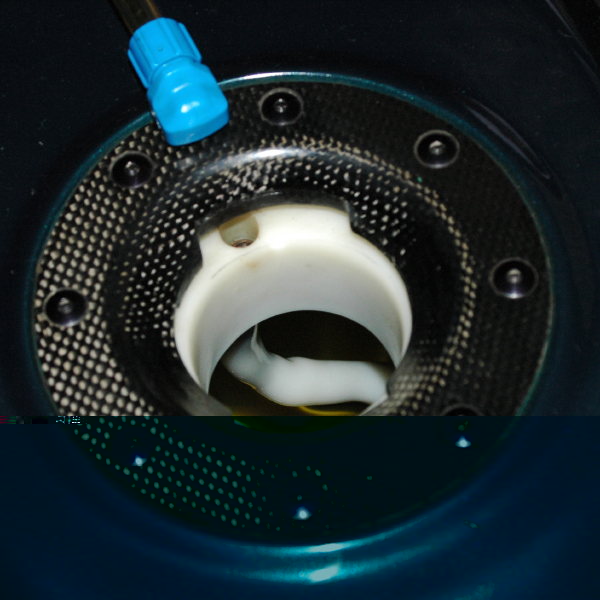

My vent looks like this:
The fitting is an overthecounter item used in pneumatic control circuits:
The maker is Festo but any brand will do, It has a tapered thread that snugs up air-tight. The hose is also from the same source.
The blue bike is the same, altho it has the stock tank cap. I screwed it directly into the tank in front of the cap.

The question was about Skorpions and tanks, tho, and there definitely can by problems there due to the materials involved in the vent, not its size as such.
Forget my one-off carbon fiber quickrelease racing cap ($$$); all stock bikes have locking tank caps unless the cap is under the seat. You can easily see the locking cap with the key inserted in the bottom picture further up.
Inside you see the vent tube going down to the base of the tank where a hose is screwed in from underneath. The large hole at the front under the cap is the vent. Any splash and also rain water to a certian extent (more theory than reality) are directed down thru the vent and not into the tank because of a slight ridge on the surface around the actual tank orifice.
