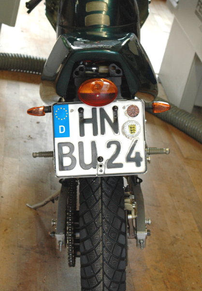

A good alternative is one of the non-specific round or oval tail light found on many pickups and trailors. Since the above picture, I have gone over to this one from Hella:
Hella Taillight.jpg (66.52 KiB) Viewed 3171 times
This one is a straight forward, all metal unit of high quality - a real threaded screw going into threaded mount holds the lens! - with two separate bulbs. The filament is no where near as long as in the twin filament bulbs of the OEM lights and lasts nuch longer. The same basic lamp is also available in round.

Postby fraserc » Tue Jul 21, 2009 4:13 am
Bill,
On the bike with the Hella lamp, what brand is that rear tyre?

Postby Bill Jurgenson » Wed Jul 22, 2009 1:35 pm
Haidenau Cup racing 130/70
