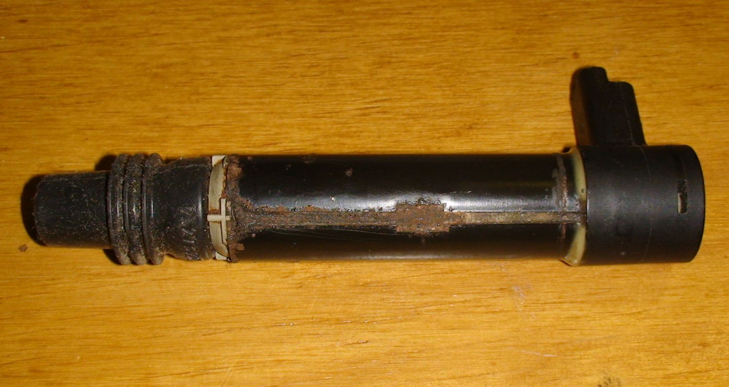

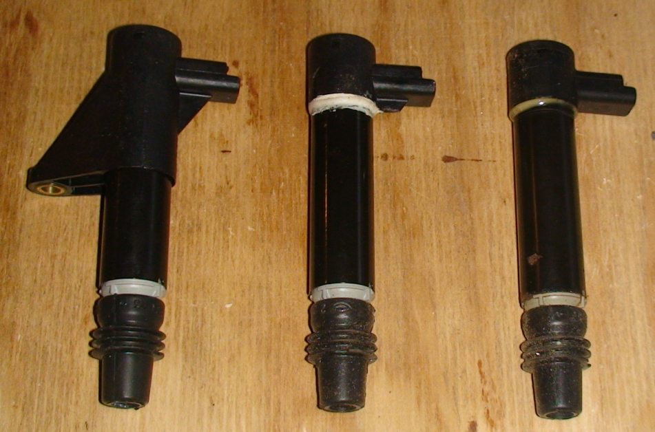

Have just fitted a Valeo Peugeot coil to my 1000ST. My bike was starting to miss on one cylinder. Pulling the coils out I found the coil on the missing cylinder (left side) was rusted. The spark plug was also very sooty. I followed the instructions for Benelli coils and it has worked a treat, see link below:
http://www.engenia.com.au/08_FuelIgniti ... Coils.html
The coil on the left is a Peugeot coil, the one in the middle my modified Peugeot coil, and the one on the right the orginal MZ coil

I meant to include a photo showing the corrosion on the left hand side coil. I think the left side may be prone to rusting faster as it is the low side when the bike is on the side stand. The right side also has some corrosion, but it was not nearly as bad as the left side.

If you search ebay for a GENUINE PEUGEOT 406, 407, 607 AND 807 V6 IGNITION COIL listing no 110426546899 these will fit once you cut off the collar and file it smooth.
Look at http://www.engenia.com.au/08_FuelIgniti ... Coils.html
This works as that is what I did after my coil failed, make sure you get the old type coil as I do not know if the new type fit as they are a different length.
